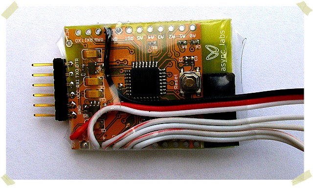

The Yellow Jacket is perfect. The size and weight is good. The Drone now flies very smooth and proportional to the stick.

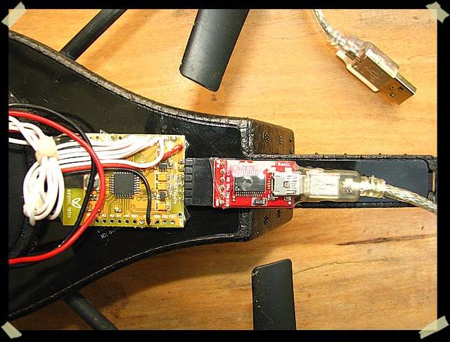

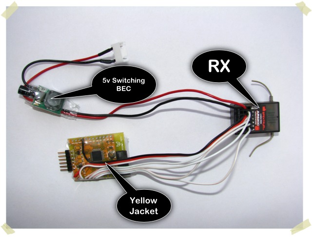

1.1) Yellow Jacket An Arduino mini clone with WiFi on-board.
1.2) FTDI USB Basic Breakout - 5V Required for downloading the sketch into the Yellow Jacket
1.3) Receiver. I'm using this one from Hobbycity But I'm sure most receivers will work.
The following RX also tested to be working
- Spektrum AR6200
- JR790UL spcm Rx (72 Mhz)
1.4) 5V power for your Rx. I'm using a small Switching BEC connectted to the balance plug of the Drone LiPo battery. A linear voltage regulator , such as 7805, would be better as it should have low noise.

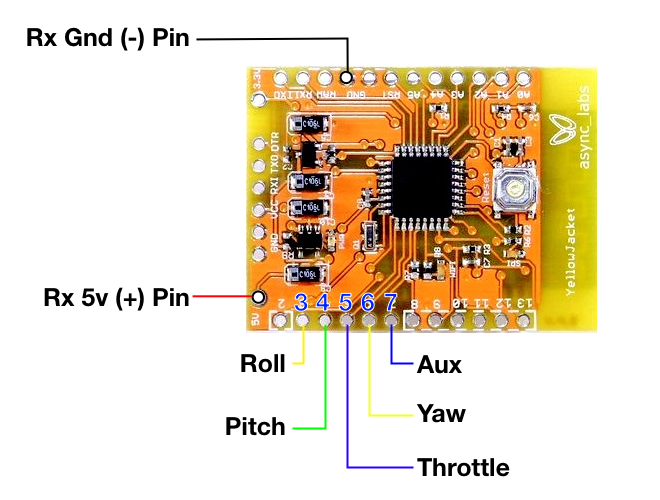

2) Wiring
We will be using the Digital pins, 3,4,5,6 and 7 on the Yellow jacket to connect to the Signal pin of the Rx. The YJ will get its power from the Rx. Similar to servo getting the power from the Rx.

4) Upload Sketch.
4.1) Plug the breakout board to the YJ. Make sure the GND pin on the breakout board and GND pin on the YJ matches.
4.2) Plug a mini USB cable to the breakout board and to a USB port on your computer
4.3) Wait for Windows to detect the new device. It should be detected as a COM port. If required, the driver is located at ...drivers\FTDI USB Drivers under the Arduino IDE folder
4.4) Open the Arduino IDE and load the Sketch RC_AR_Drone_V2_YJ.pde
4.5) Under Tools->Serial Port, choose the new COM port that has just been added.
4.6) Under Tools->Board , choose "Arduino Pro or Pro Mini (5V, 16MHz) w/ATmega328"
4.7) Now upload the sketch to YJ
4.8) Once uploaded, open the Serial port monitor under Tools. Set the speed to 38400.

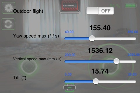

First connect to your Drone from an iDevice and start with the following values. These values effect how sensitive your drone is.

- Ar.Drone sensitivity , Throttle, YAW, Roll and Pitch rate can be configured in the "user_config.h" file. iDevice no longer required to configure your Ar.Drone

You will need
1.2) FTDI USB Basic Breakout - 5V Required for downloading the sketch into the Yellow Jacket. Also being sold at Spark Fun
The following TX/RX also tested to be working
- Futaba 9CH with Assan module and X8R7
- Spektrum DX7 and AR6200
1.4) 5V power supply for your Rx. I'm using a small Switching BEC connectted to the balance plug of the Drone LiPo battery. A linear voltage regulator , such as 7805, would be better as it should have low noise.
2) Wiring
4.4) Open the Arduino IDE and load the Sketch RC_AR_Drone_V2_1_YJ.pde

10) Flight procedure, in the following sequence
10.1) Plug in Ar.Drone battery and wait for all lights to go green. If you have been flying your drone with iDevice, you need to press the "unpair" button at the bottom of the drone before carry on. Or with the latest Ar.Freeflight , press the "unpair" in the config screen.
10.2) Move all stick to mid position and CH5 (Aux) switch to low postion. Switch on your Tx.
10.3) Connect power to your RX
10.4) In a few seconds your YJ should now display a solid Green led. And the Motor LEDs should flash alternately. Which means the YJ is now connected to the Drone.
10.5) Flick the CH5 to high, your drone should now take off and hover.
10.6) Flick the CH5 to low, your drone should now land.
Video showing the "Take Off" procedure
RC Controlled Parrot Ar.Drone - Take off procedure (2 min 18 sec)
For your first flight I suggest you test it in-door over something soft. I do it in the bedroom (the flying I mean :-) ) and over a mattress.
One tip, if your drone hovers and cannot be command to land, just grab the drone firmly and tilt it 90 degrees. The motors will switch off.
11) Flight procedure with Video downlink, in the following sequence
- Power your drone and wait for the green lights. Do not power your YJ
- Push the un-pair button at the bottom of the drone. The green lights should flash
- Connect your iDevice to your drone
- In configuration page of the Freeflight, make sure the "pairing" is off
- exit the configuration page
- you should now see the video as per normal
- now power your YJ
- once YJ booted, the green lights should now stop flashing. The motors LEDs should now flash alternately.
- your drone is now ready for flight
- Note: do not touch any control on your iDevice while flying your drone from an RC Tx
