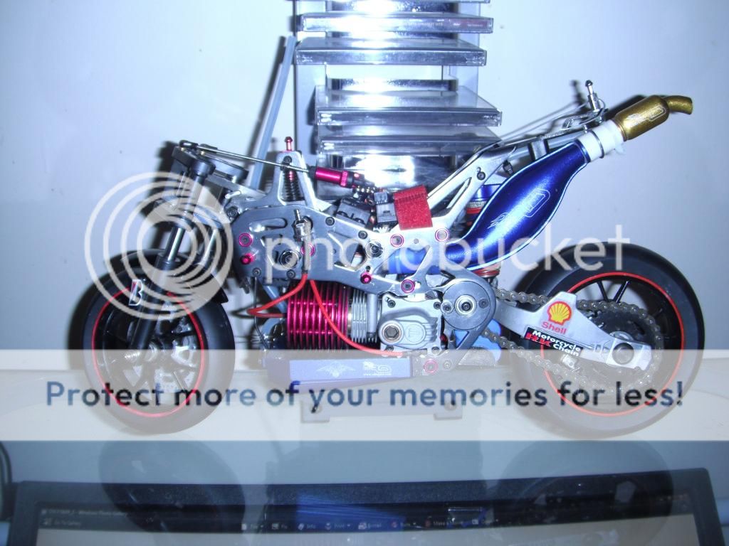

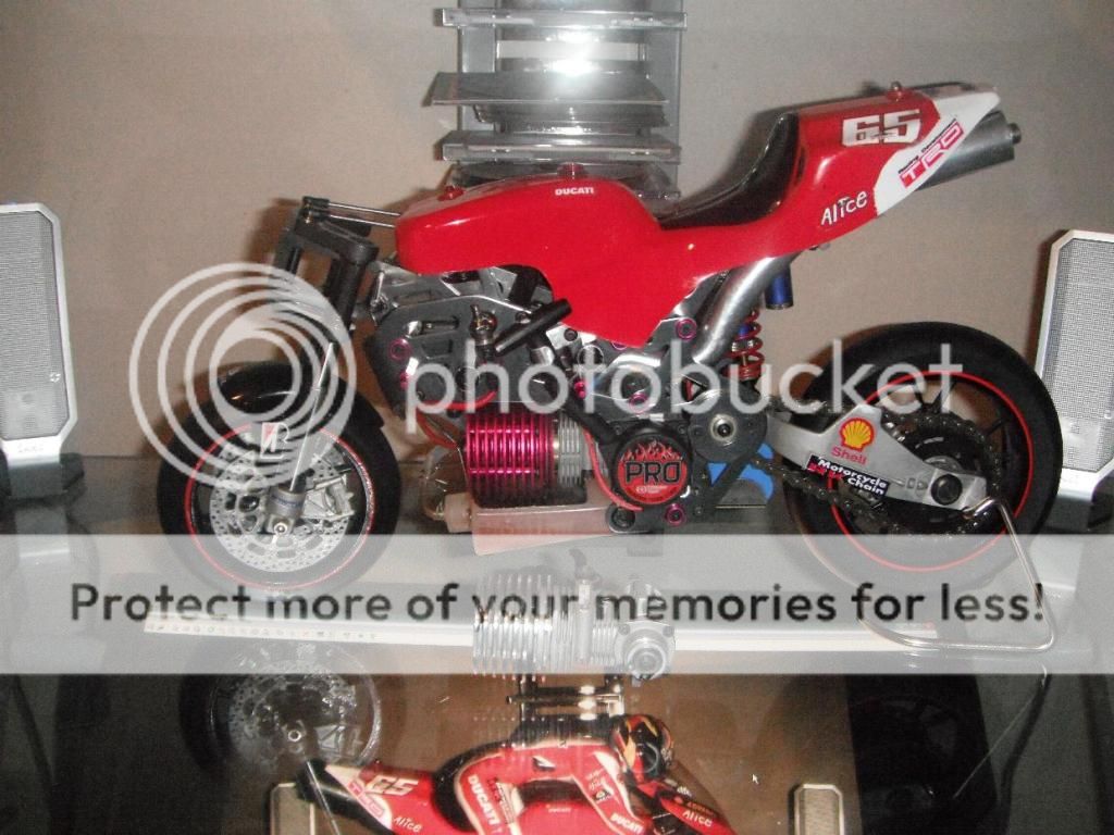

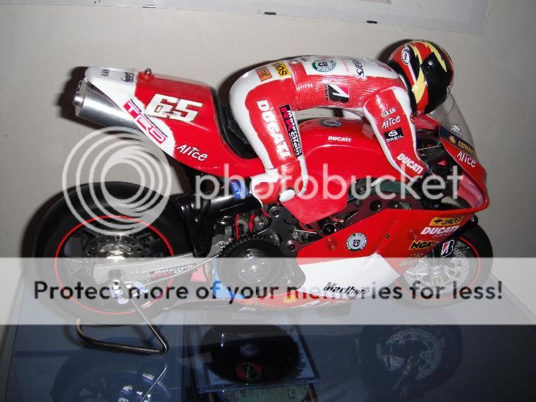

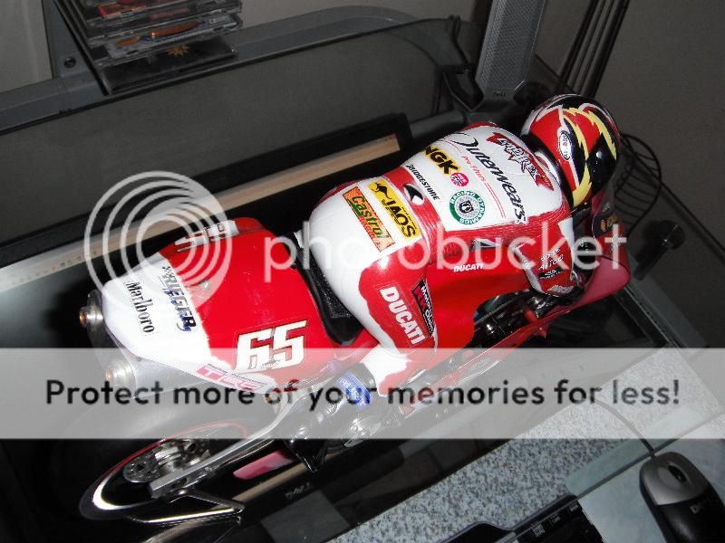

John from Ont. This is my rebuilt TT Ducati 999. New power plant and paint sceme. TT.18 Pro Bx. 3cc, Integy oil shock, new steering dampers, and a few other cosmetics.front disk break.

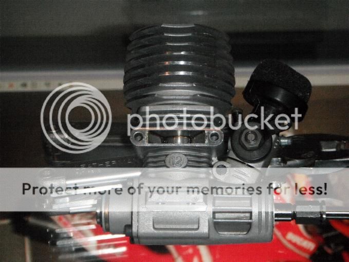

The early original TT Ducati 999s came with a TT12. I dropped out the original TT 12 and installed a new TT 18 BX Pro. {Not the TT BK. No longer Available}
Check out the size comparason of these two engines. Massive engine for this little bike. Had to chop the frame, reverse the carb, and trim the head in four places to squeeze it in.
Engine TT 18 BX pro

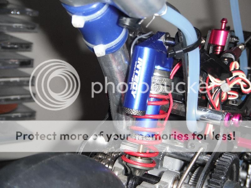

25lb Integy oil filled piggyback shock
