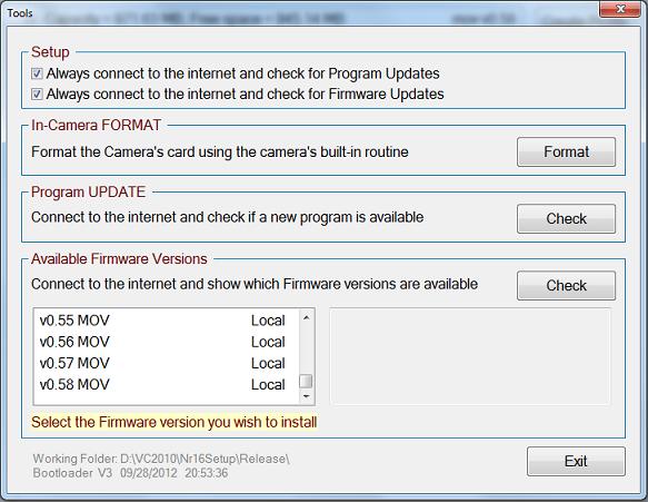

Firmware
Firmware for the #16 camera does not need to be replaced with new firmware every time a user configuration change is desired. Those changes are best done using the GUI tool (see above).
Also, the GUI will determine if your camera firmware is out of date, download the latest firmware if you agree, and install it for you, taking all the potential for user error out of it. You are strongly advise to ALWAYS use a GUI tool for all camera firmware changes.

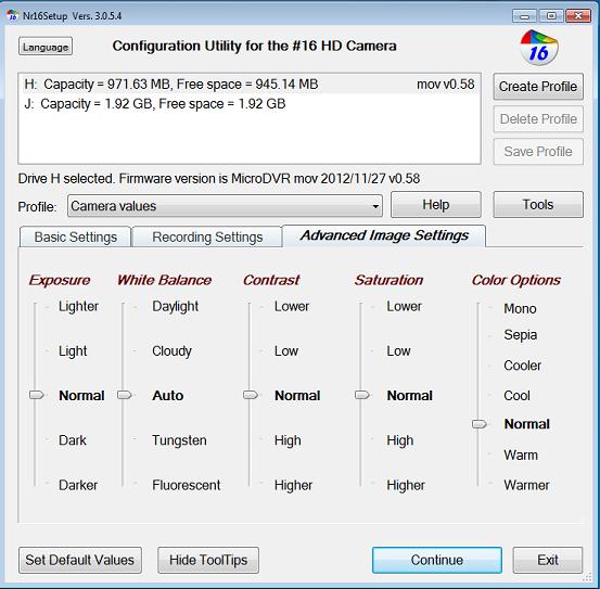

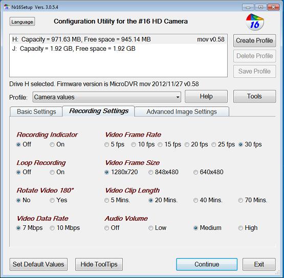

In the beginning...
I would like to take this opportunity to specially thank Tom for all the hard work that he has done, and is continuing doing, for this camera.
He contacted me a few months ago and asked me if I would consider writing a configuration utility (GUI) for the upcoming #16 (#11 plus/ultra/ultimate/elite etc. at that time).
I was absolutely delighted as this would be a change to my daily work programming gigantic, ultra complicated and messy applications.
After a few months of silence, the developer was almost ready. OMG, I was taken almost by surprise . From then on, things went very fast indeed. Luckily I could use the time-setting programs that I had previously written for the #11 as a base.

Instruction Manual and Configuration Program
This is the original GUI which I created in co-operation with the developer and Tom. The first version was released on 16 December 2011 and has always been updated in synchronization with the latest firmware versions.
The program is a native Windows application specifically written for the Windows operating system (XP and above) and does not require any 3rd party runtime system to be installed. The simple and extremely user-friendly program is fully plug-and-play but also fully supports the older file-based configuration method. The program will also run on Linux and Mac systems running the Wine compatibility layer.
A full feature list is shown after the introductory pictures below.
The latest GUI software configuration tool together with the latest instruction manuals (User Guides) from both the manufacturer and the program may be downloaded by clicking here
I strongly recommend that you check the above site on a regular basis because I will be keeping the program instruction manual up-to-date, especially the "Trouble Shooting" at the end of the guide. Also, new firmware versions may incorporate new or modified parameters which will also only be available in the latest GUI version. You may also set the program to check for software and firmware updates automatically, each time you start the program.
The above site does not contain any firmware files. All available firmware can be downloaded from here.
Windows GUI software configuration tool (click on image below to download the program)
...and the integrated "Help" (User Guide - click on image below to view/download)
The configuration tool needs no installation whatsoever. Just unzip it to your favorite location, even the camera's SD card if you feel so inclined.
These are just a few of the software tool's highlights:
  • Extremely easy to use, even for inexperienced users. FUI (friendly user interface, as one member posted)
  • Native Windows program. Works on all Windows versions (XP and above) without the need to install additional run-time environments.
  • Truly plug-and-play but also supports the old configuration file settings.
  • Large fonts for easy reading.
  • Dialog can be resized by simply dragging the edges. Fonts will also be resized!
  • Works on low-resolution monitors.
  • Built-in program Help.
  • Tooltips which can be enabled or disabled.
  • All possible parameter settings are clearly visible, making their selection a highly efficient, one-click procedure. No need to scroll data into view.
  • Modified parameters are shown in green.
  • Very detailed error and warning messages.
  • Fully integrated detailed user manual (User Guide) which can also be printed.
  • Profile management for advanced users (different configurations).
  • Real-Time ability to read the current settings from the Camera (plug-and-play).
  • Modify all the camera's settings. Original values are shown in green.
  • Slider controls make it dead easy to set the values for Exposure, White Balance, Contrast, Saturation and Color Options.
  • Set the camera's date and time to within 1 second accuracy (if required), standard when using the USB interface.
  • Format the MicroSD card using the firmware's built-in routine.
  • MicroSD card will always be "Safely Removed".
  • Automatic or manual Program updates.
  • Automatic or manual Firmware updates. Previous parameters are saved when upgrading. Online firmware description is shown, if found.
  • Full firmware check-sum validation check. It is all but impossible to install a corrupted firmware file!
  • No program setup required. Just download, unzip the single exe file, and run.
  • Can be run from any location, including the camera's card or Windows "Program Files" folder (supports security elevation).
  • Invalid parameter combinations are clearly noted in the tool tips. Invalid parameter settings will be disabled.
  • Foreign language support. Currently available in French, German, Italian, Romanian and Spanish.
  • Translation is done by individuals - it is not automatically translated and then edited as best as possible.
  • Please contact me if you are willing to translate into other languages.
  • Dynamic language selection. If a language DLL exists, the language can be selected at any time. No parameter settings are lost.
Note:
As of version1.0.0.7 it is possible to create and keep the read-only attribute of the configuration file. This can be useful if you want to load different configurations from different cards. However, normal users do not need this special functionality. I have posted information about this new functionality here.
Foreign language modules (DLL, Dynamic Link Libraries) must be copied to the same folder as the program. On execution, the program will show a language button if it finds one or more language DLLs. Once set, the program will always start in the language previously selected.
