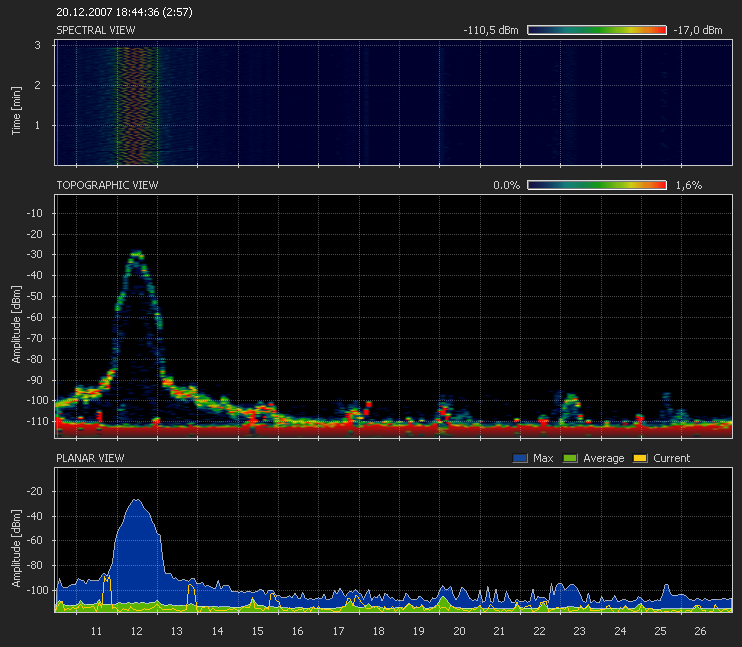

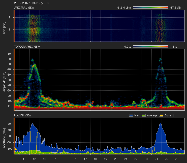

Hi,
I have done some testing too and was no able to get XPS to change the channel. I found out some other facts however using a portable Spectrum Analyser.
XPS uses 16 Channels in the 2.4 Ghz band, 5 Mhz wide. It allocates one channel for use. Center frequency for each channel can be calculated as F = (2405 + 5 * (k - 11)) MHz, where k = 11, 12, ... 26. (Exactly as Zigbee does)
This is the typical signature of a XPS (power level 5) system:
For the tests I tried to raise the noise floor first by using an analog video transceiver set to the same frequency range as the XPS system. That did not caused it to jump, it just stayed on the same channel.
I did a second test using a DX-7, which is know to output quite a hefty signal. I noticed that in my environment the XPS system always starts on Zigbee channel 12. So I let it allocate the channel, and put the system away to shield it. I then started a SpectrumRC DX-7 for as long as I got it to work on the same frequency range for its lower channel and put that away too.
I then pulled out the XPS system and checked its channel allocation - still 12. Then I added the DX-7. XPS stayed on 12, no jump.
As you see the channels of the XPS (Zigbee Ch 12) and DX-7 are now overlapping which must cause the noise floor to raise for both devices. Still XPS did not choose to jump. (The signal at 2472 Mhz is the second channel of the DX-7)
I am still trying to get it to do the channel change, next time I'll try with some othe analog 2.4 equipment.

Frank, did you try moving the XPS Tx and Rx away from each other while the
external noise source was close to either one? I'd think the analog video Tx
would be the worst (my 500mW 2.4Ghz video Tx on 3 of its 4 channels
takes out my home network completely).
If you monitor the current draw at the XPS Tx closely you'll know exactly
when it starts retransmitting packets (either due to the Rx not
hearing the Tx and not sending Acks, or the Tx being so overwhelmed
with noise that it can't hear the acks from the Rx.) because
the current draw will go up (On my Optic 6, it shows the voltage go
down immediately). I think if you move the Tx and Rx away from
each other and put the noise source very close to one or the other, you'll
see the Tx start retransmitting, and then negotiate a channel switch.
ian
