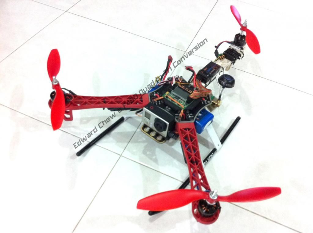

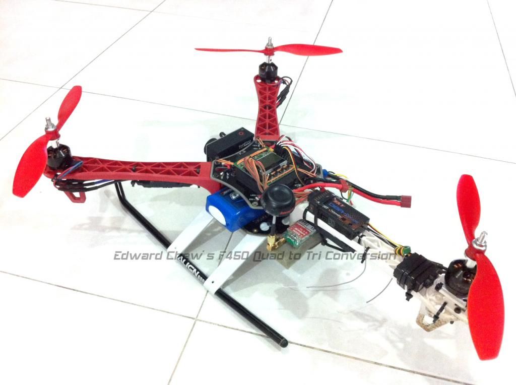

Build of the F450 Quad to Tri
Original thread here,
http://www.rcgroups.com/forums/showthread.php?t=1869971
So i got this F450 laid around without electronics last year(transferred to Reptile) and stumbled upon this yasuo840 on youtube showing his F450 converted a tricopter! it's a damn good idea!
Finally got time recently and kicked my ass to start the project.
And the parts were actually already landed in my room like months ago. I ordered them based on those good folks who shared tips of their diy tricopter such as,
1) David from http://rcexplorer.se/category/projects (check out the Tricopter V2.5) for tips on the rear servo
2) Oldman(not sure his name) or Hallstudio from http://www.youtube.com/user/hallstudio for the setup
Here's the result, took me one night
Specs
- F450 quad frame
- Sunnysky 1100kv
- F30A ESC
- HBK 30A props. (Lasted multiple crashes and even it's bent till there's a white spot, it still flies w/o complaint!)
- Test Zippy 4S 3000mah or 3S 1800-2200mah. The 4S 2200mah doesn't fit. Damn
- Trex700 landing gear ;D
The flight experience
1) First flown with 3S just to find out how it will fly, indoor. The maiden flight, servo was wobbling quite bad until you can hear oscillation/resonance sort of thing. So tried
- setting Yaw gain and Servo filter, tuning it up and down and still it's wobbling even at Zero gain.
- props off, check motor, prop...Continue Reading
