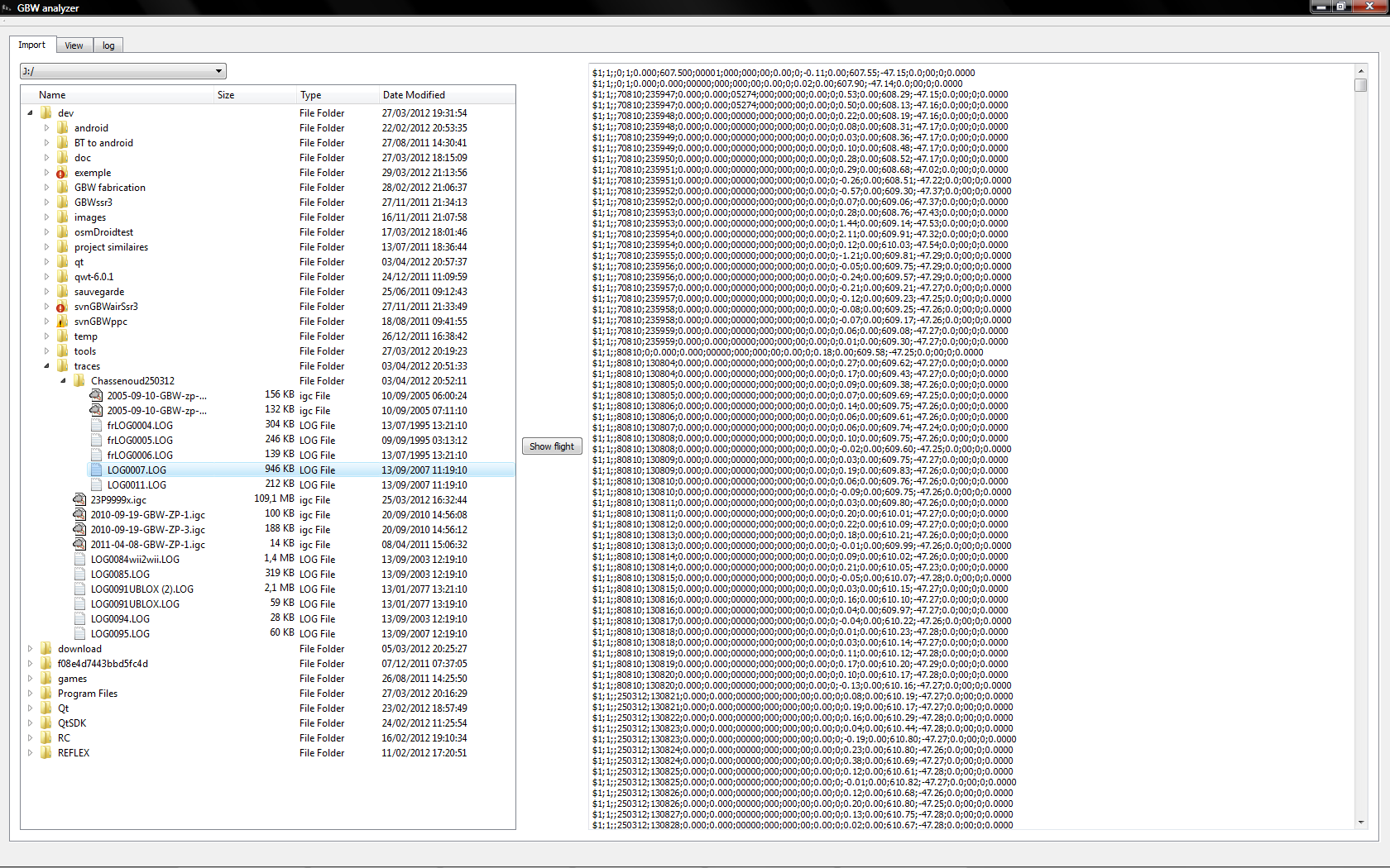

Once you have filled the SDcard with flight logs of your beloved sailplane, it is good to be able to store them and see for each one their statistics and 3D traces. So I wrote a little tool that do just that.
First import a log file :

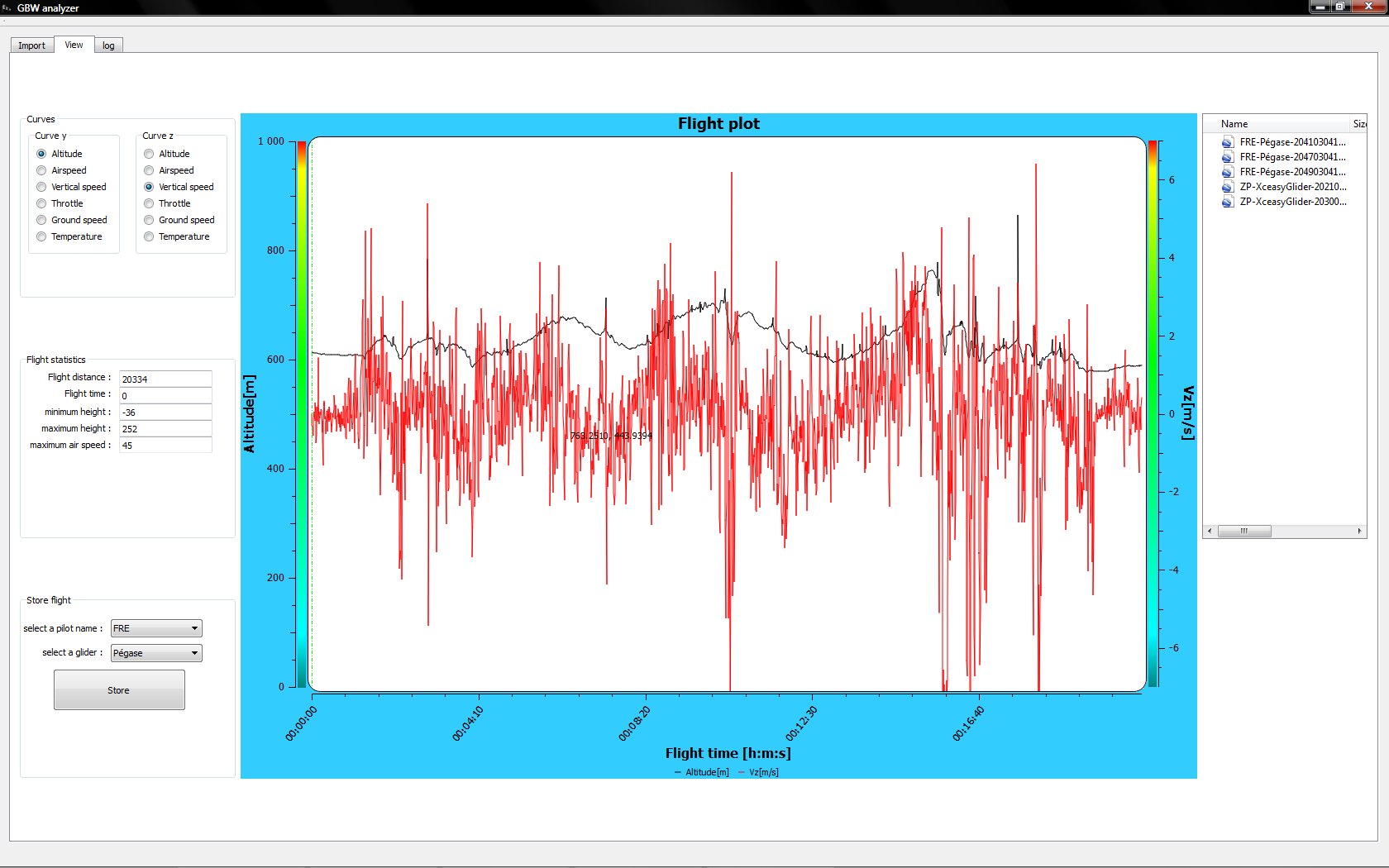

then see the graphs and statistics (not finished yet here). You can view 2 curves type at a time from the selector on the left, then you can pan and zoom the graph at will :
Then you store all those log and kml files produced here. There are 3 tables, one for the sailplanes, one for the pilots, one for the logs. Pressing the store button on the graph tab will allocate the log to a paired pilot/glider :

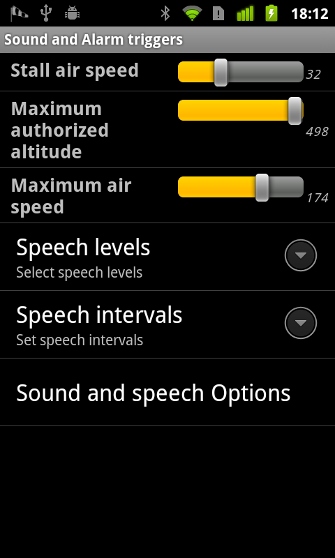

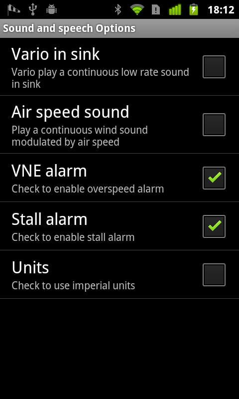

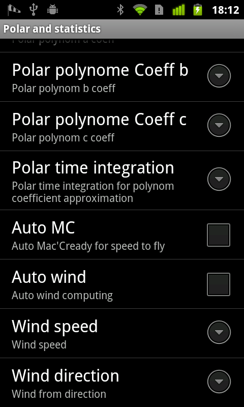

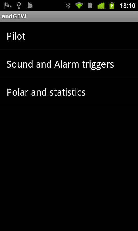

While I was waiting for a new set of pcb to test a new gps chip, I decided to revamp the menus and settings. I also introduced some new stuff after I read a few interesting thread in the cross country soaring forum (more on this later) :
RC XCsoaring.
So first to be able to debug the application more easily, I wrote a little glider animator. By tilting the smartphone you can turn, climb or go down, so you can test all your vocal and alarm setting, and get used to the race module. The animator is not realist at this point but I'am working on it. It would be fun to have a real flight model behind that.
GBW application glider simulator (0 min 45 sec)

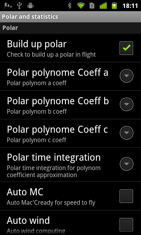

After having read the thread mentioned above, I decided to take a look at polar curve and speed to fly. All those notions are well established in the real rc glider world, not yet in the RC communauty. But with the introduction of GPS assisted XCountry and GPS race in europe, those kind of data are of value. The glider polar curve is the one that connect air speed and sink rate (in stable atmosphere) from where you can compute many thing like the ideal speed to fly on a race, etc... So why not trying to get experimental data and build this curve in real time ? I decided to implement a polynomial approximation from the cloud of points(airspeed, sink rate) gathered during a flight (I carefully read that document http://xcsoaring.com/techPicts/Edwar...nce%20test.pdf). After some math stuff, you have a,b and c of the polynome. If you don't want to measure it, you can directly enter those coeffs from the menu. You can also set the Mc Cready in auto mode or change it by yourself. If you select to build your polar, you can specify the record length in seconds (FIFO buffer). In the end you can also take a look at the altitude, vario, ias, polar curves. All this is WIP and waiting for comments enventually.

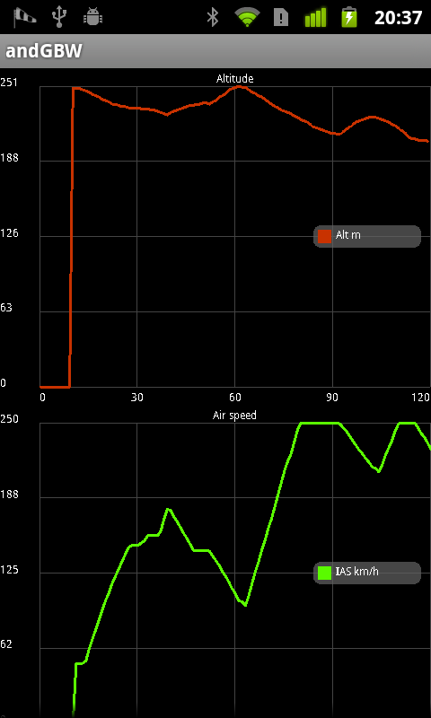

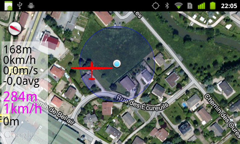

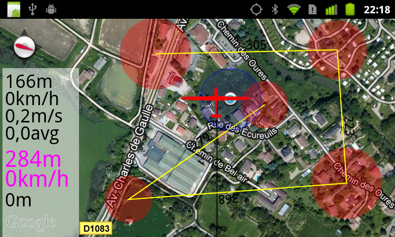

I've had some time to make some works on the android software, it is glider oriented and the goal is still to achieve racing almost like the real ones.
Screenshots here are captured from the dev tool Eclipse and are the images taken from the real device display driver.
The blue circle figures the GPS position uncertaincy of the smartphone (here a Nexus S). Our glider in red gently resting in the backyard.
On the left, we have a QNH altitude of 168 meters (I can reset to 0 and have the glider relative altitude)
IAS show zero km/h.
Vertical speed is zero.
Vertical 10 sec averaged too.
GPS altitude 284 meters.
Ground speed zero.
If I want to add turnpoints on site, I just press menu->create TP and tap where I want to place one. I can place as many TPs as I want. Distances between TPs are shown in the middle of each segment. I can remove or move a TP the same way. The glider will have to pass in each turnpoint radius in the right time windows at the right altitude windows. Altitude, TP direction and distance are spoken by the application. Some sound FX are added for the race and glider VNE and STALL speed.
The variometer play sounds like real glider.
