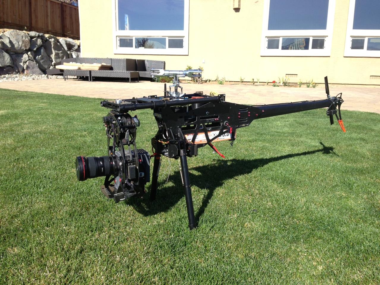

Posted by STMPNGRND | Apr 19, 2013 @ 01:50 PM | 6,711 Views
Given the intensity of forum chatter these days surrounding brushless gimbals, our gimbal development will stay under wraps for the time being.
However, major changes have been implemented on the CK800 since the last update. The airframe has been optimized to carry the molded carbon boom(Goblin) and house full retract landing gear. The retract system quickly releases for easy transport. With the new frame design the CK800 is capable of swinging 830 mains with room to spare. I haven't put it on the scales yet but it is arguably the lightest 800 class AP ship out there with no sacrifice in strength and flight performance....this heli could do 3D without the camera! All electronics are neatly contained within the frames and all batteries are easily accessible for fast turn around on the ground. All mass has been concentrated as close to the CG point as possible along all 3 axis(swing weight reduction) to insure the best flight characteristics. 3K carbon all around makes it a sharp looking and high performance bird.
Here it is with it's fully retractable landing gear, PS1 gimbal, RED Scarlet and one very stoked owner of CopterKidsLLC.

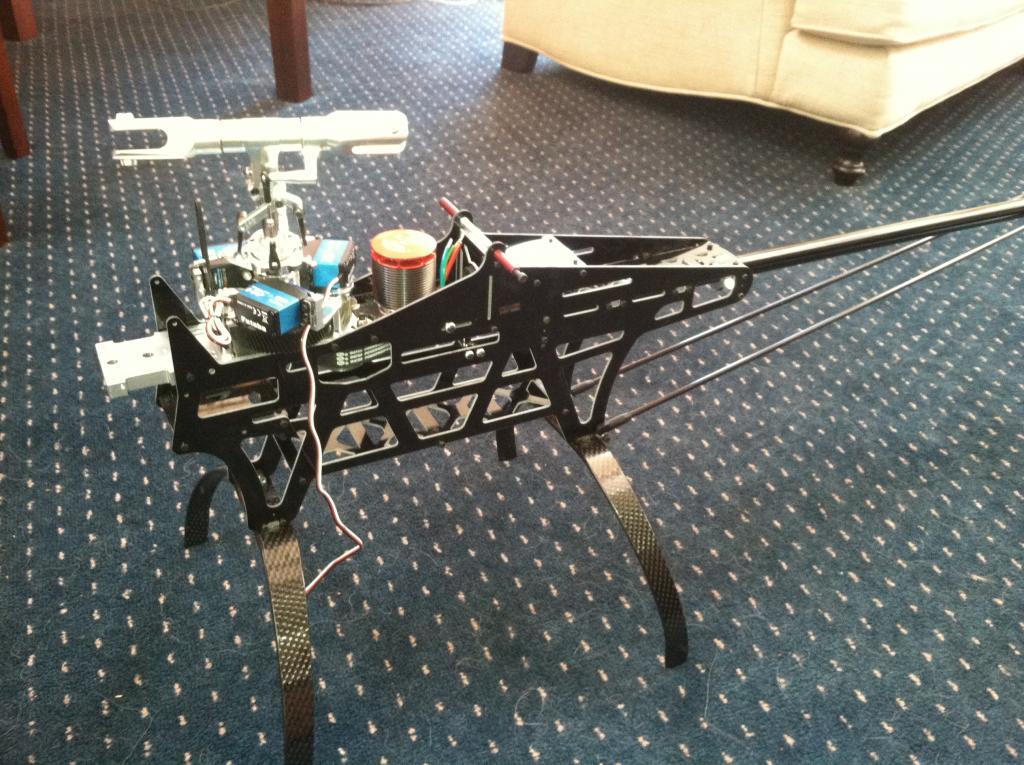

Posted by STMPNGRND | Mar 07, 2013 @ 09:52 PM | 6,315 Views
Another fun project for my friends over at CopterKidsllc.
These guys push the limits of AP when it comes to high speed & high agility flying while getting the shots.
Here is the first proto of the CK2 airframe now based on a goblin770. This configuration allows the absolute closest you can locate the cg of the gimbal to the CG of the airframe...even closer than an underslung!
Up next is to design and fit retractable landing gear and a brushless direct drive gimbal.
