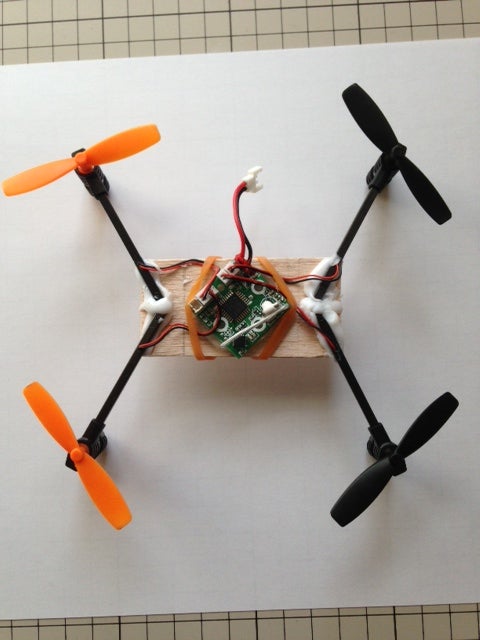

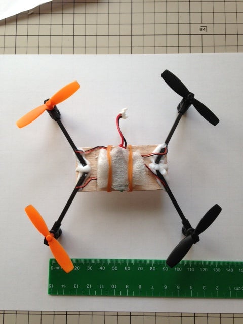

I have some parts laying around, so I made a little XS quad (hm, is XS the right type?):Next step is to add #808 camera on the bottom of the balsa body
Update: I forgot to put some interesting links in the end
