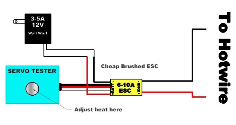

Seems like I post this diagram quite often, so I thought I'd just post it here and link to it.
The diagram tells the whole story. Very simple and cheap to build with parts you probably already have lying around.
As for the hot(wire) itself, everything from stainless steel fishing leaders to guitar strings to small steel push-rods (piano wire) have be used with great success. Personally, I use nichrome, but that's just because I had a good supply of it on hand and have never had any trouble with it.
This are many other ways of powering a hotwire, this is just a quick, nasty, throw-together conglomeration that works in a pinch.
