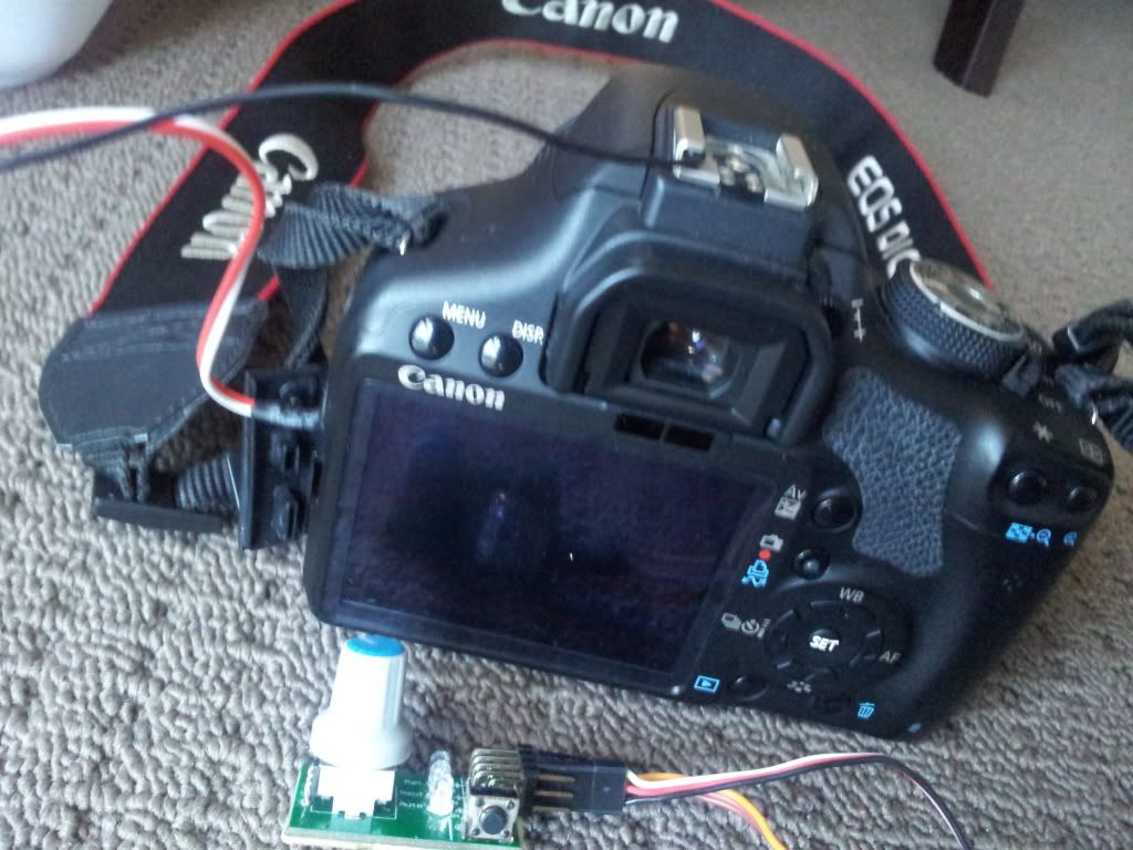

Hi there guys, its been really frustrating past 2 nights, im stressing out trying to find a good shutter, i bought this sled shutter for canon, and spent 18$ over it, but luckily i had to cancel it because i found a way, well, i had to revive some threads that are considered "no useful", but hey, im a man of my own failure, so i tried it anyway, ,
I ended up on this 300year old thread that says you cant use your controlled switch as a shutter release, well i believed but i had time so i tried it, well its true it didnt work the way they think it should

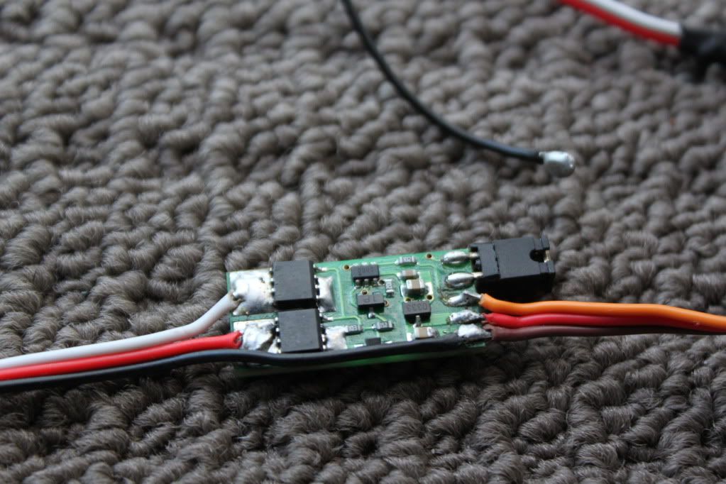

thinking back with this switch, i remembered how the connections are so important.
so i mocked around a little bit and came with the idea of placing the negative somewhere negative well the only part on my Kiss X3 was the hot shoe().
anyway i connected them negativitys together and guess what i jumped trough the roof the split second i heard the continuity on my meter (Literally)
Btw, here are some pictures and vids ( I will keep updating as my internet currently reached its download limit and now i upload at 10kbps )

Just a short look of how i connected it
