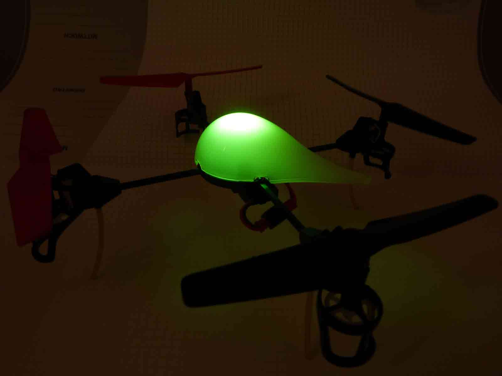

Hubsan X4 illuminated 1.0
The Hubsan X4 is the smallest RTF quad on the market (yet).
Due to its size (or lack of) and colour it has a quite low visual profile.
So flying outside - where it belongs - it is really missing some navlights.
This is my simple solution, I took:
  • 4x 0603 LEDs: 2x blue, 2x red
  • 2x resistors: 1x 22 Ω, 1x 47Ω
  • 32 gauge magnet wire
Soldering the 0603 LED was a pain in the **s
Wired according to following pictures:
