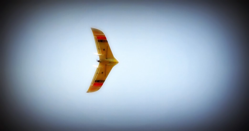

I recently reached a personal best 114 km distance covered with my Phantom wing. This was all LOS in a race track pattern to prove the capability and efficiency of the setup. Not a bad accomplishment for an off-the-shelf setup with mostly Hobby King grade stuff.
Details here.
Photographing your plane as it flies itself.
Google Earth track of the flight
