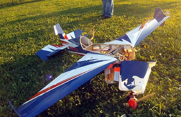

Posted by 7oneWo1f | Jul 13, 2013 @ 12:19 AM | 7,339 Views
This was a great plane, and I got a lot of flights on it.
poptopkinginjured (0 min 46 sec)
It doesn't look like it is too much damage but I am going to keep her down for awhile and fly some other planes that have been neglected. At least for awhile. Still debating repair versus replace and if replace, yellow black versus red white and blue.
