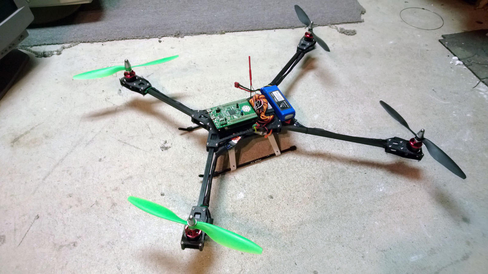

Posted by VArchT | Jun 13, 2013 @ 03:20 PM | 6,889 Views
I've had the parts lying around, for quite a while now..., to put together a FPV Quad and finally did it. The FC is a ST F3 Disscovery Board sitting on a breakout board from http://www.rcswift.com/catalogue/ it is running the flyingF3 code from Tau Labs. It is flying now, next is to add sensors and GPS and get into the UAV goodness.
Here's a pic from mid build , final build and flight video to follow.
