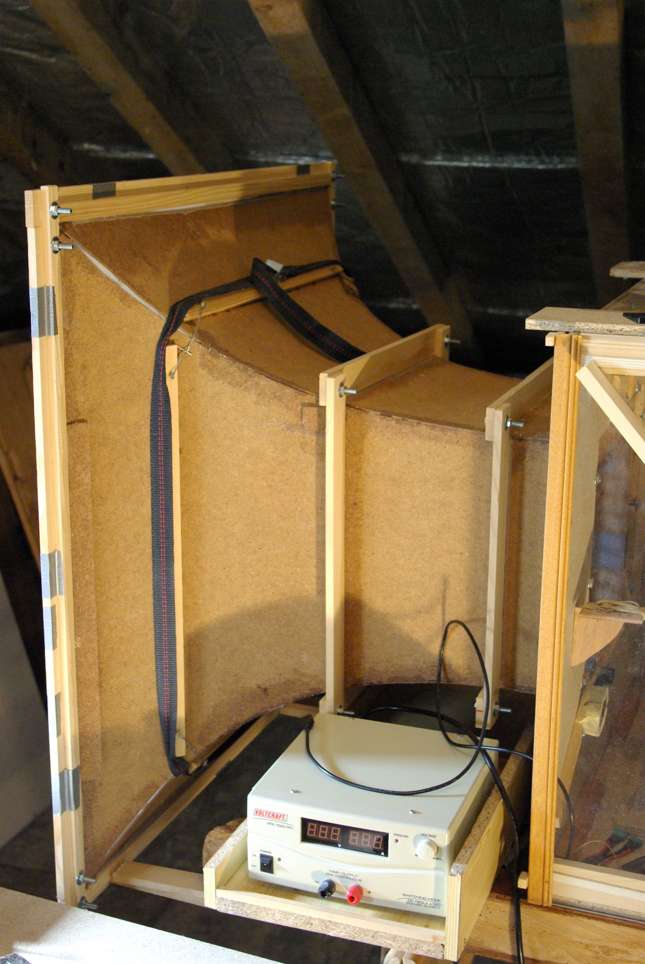

Entrance cone of the wind tunnel:
Even the belt was not enough to curve the four parts in the right position!
The curve is simply parabolic function.
The entrance cone is kind of too short, but I needed place…
Inner side surface is not perfect.
