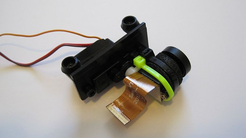

Another short but sweet blog.
This is a simple pitch-only gimbal for the Mobius that could also be applied to the 808 using an 8" extension cable.
I used the micro servo out of my Joysway Super Mono X.......bracket and all and zip tied it to the servo arm using some foam tape to help keep it secure:
The holes of the bracket line up pretty well with the Emax 250 Pro camera mount so I just zip tied it in place. I did have to add 5mm standoffs to the existing ones for extra clearance:

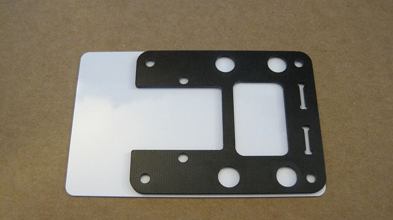

Many of us have struggled trying to make our own anti-vibration mounts from foam, zip ties, surgical tubing, ear plugs, etc. A lot of these solutions are either bulky and require a lot of clearance above and\or below as well as take a lot of time to glue and engineer them. That's not to say they aren't good and this isn't meant to put down the ingenuity of those solutions.
The 'professional' mounts all use damping balls so why not use those? How do you mount them and what to? Well you have those old credit cards or spam advertising cards you get in the mail, why not put them to good use?
You'll need a standard 1/4" hand hole punch available at any office supply or crafts store and 2 credit cards. While you're there an 1/8" hole punch also comes in handy.
I suggest using some worn out cards you have laying around so you can experiment with making holes and testing. Once you've settled on pattern and determined if you need more or less dampening balls, you can punch your design into fresh plastic blanks. Here I'm using the mounting bracket off a Diatone frame:
Place your template over the card:
Punch your holes, don't worry if they're a mm or 2 off:

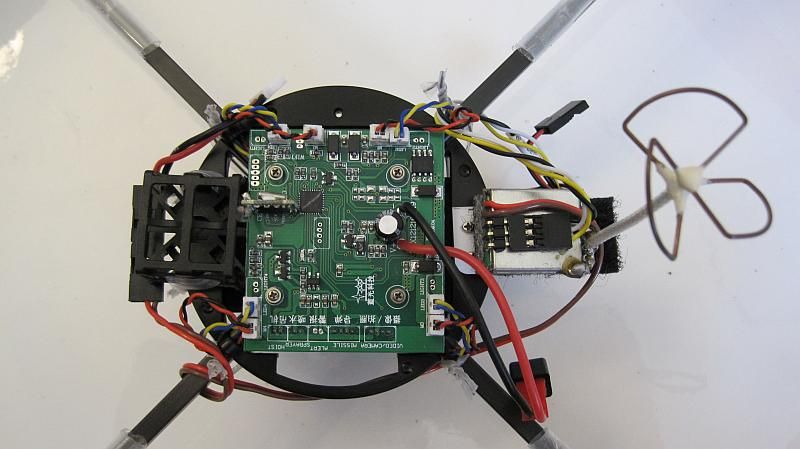

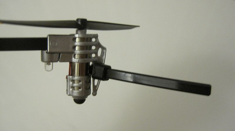

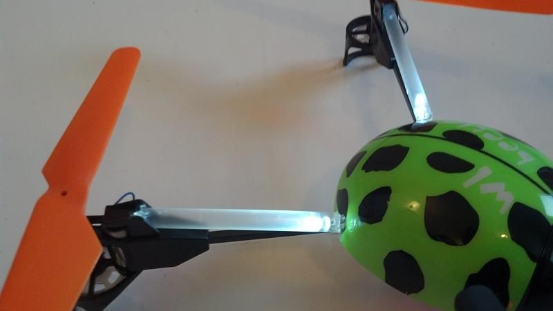

FRE (Filipino Redneck Engineering) brings you another great WL Toys-based Frankenquad. This latest monster consists of a V252 Gumby board and upper frame mounted to a lightened V212 chasis. The result is a mini quad that's super accro when you want it to be with plenty of yaw rate and can go back to stable flight like it's bipolar.
Here we cut the booms off just past the LEDs
We secure to the frame with my favorite fastener of late, wire ties.
Indoor flight test:
This is the FrankenYaw: A V252 board on a V212 frame. Indoor test (3 min 30 sec)
Outdoor fight test:
This is the FrankenYaw: A V252 board on a V212 frame. Outdoor test (4 min 16 sec)

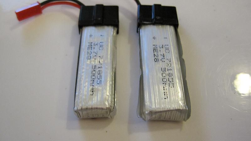

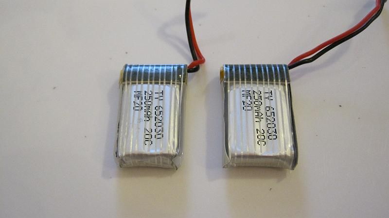

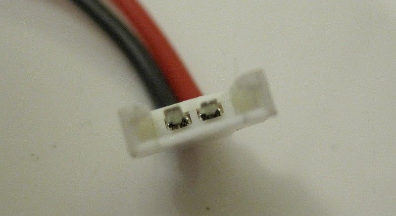

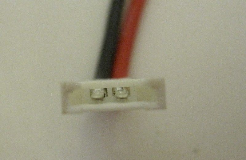

Here's a quick tip to make your micro and mini LiPos slide into your battery bays easier. Simply smooth the folds over by running them against a smooth surface such as your table top. Fold the sides over first and then fold the ends over at the corners:
Left is folded over, right is stock:

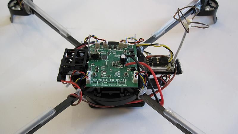

Theses are the specs of my V262 FPV setup:
Video transmitter: 5.8 Ghz 200 mW 58000 can run off of 3.3\5V
Video receiver: 5.8 Ghz RC 305
Flight Battery: Turnigy 950 mAh 25-50C LiPo
Both are fitted with cloverleaf antennas from Banggood
The VTX is powered by a standard 1S LiPo. I soldered a servo jumper on the VTX so I can transfer it and power it from my Walkera QR X350 and then made a servo-to-micro losi adapter for when I have it mounted on my V262. I took an H36 frame, trimmed it and mounted it upside down to the front of the V262 mainframe using wire ties. The VTX itself is Velcro secured to a cut piece of credit card that I screwed into the mainframe.
I've stripped the Mobius TV out cable of its outer jacket in order to save some weight. The Mobius is held on via wire ties using the holes in the Mobius chasis.
Pictures:

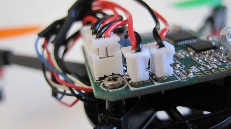

I soldered on a battery lead in parallel to the main for powering the Mobius:
It runs underneath and extends to the front:

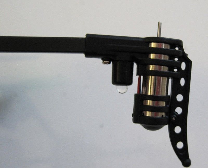

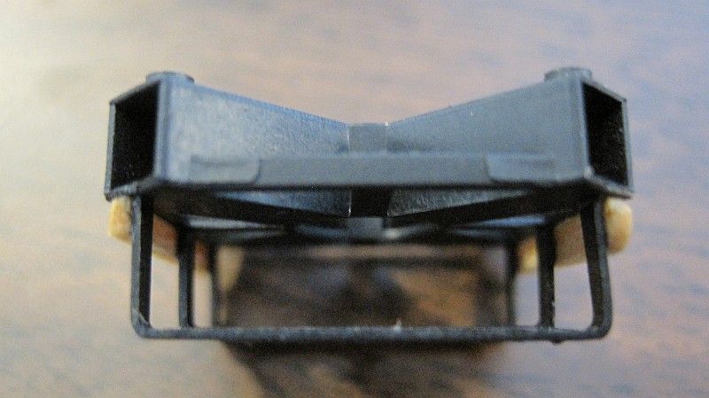

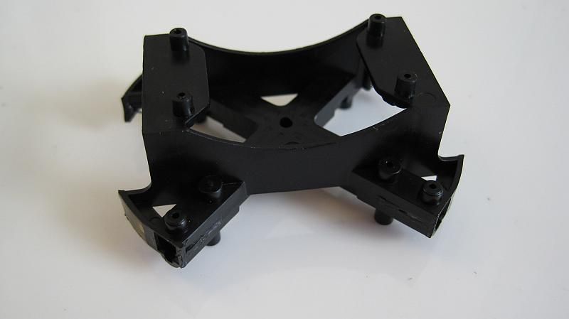

I butchered a V212 landing gear housing, keeping only the mounting bracket. you can see the stock frame\landing gear assembly on the left:

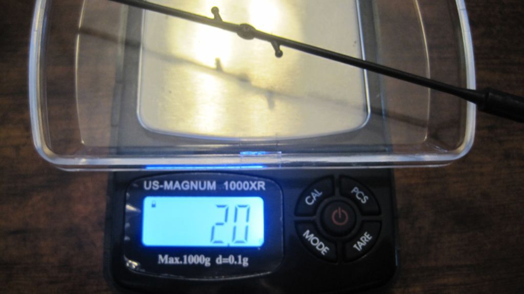

You can save considerable weight just from removing the landing gear skids as well as the sub-frame used to mount it. Removing those will shave 4.6 grams alone. In addition you can shave .8-1 gram from butchering the frame. I feel by cutting it in strategic places you can still maintain structural integrity:
UPDATE: I'm no longer using 3 LiPos. The 808 will run fine off the Turnigy 600, so now I only run a separate battery for the VTX.
The quad with 808 camera (A lens), VTX, cabling, and 2 808 LiPos weighs about 85 grams. I'm using a Turnigy Nanotech 600 35-70C LiPo for the main battery which weighs an additional 16 grams. For comparison, a fully-outfitted V959 with camera module weighs about 82 grams without LiPo.
