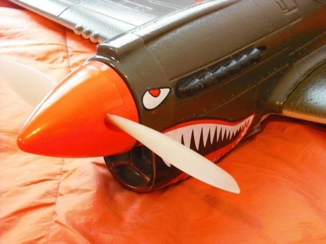

Initial unboxing of the '40 was good, everything was there and nothing was missing. Parts seem well made but the finish could be a little better. Its really nothing that you could pick up on from even just a few feet away (ie it'll look good unless you hold it up to your face) but caught my eye as I was assembling it. Whatever, its a damn cheap plane so I didn't expect it to look like an expensive one and it still looks very good in my opinion.
The stock prop is an 8.5 x 9 and also quite heavy... which means that it will never be fitted to my plane. There is nothing physically wrong with it, but for the size of the engine (25~30g 1300kv outrunner) I would not personally have chosen a prop with those dimensions. The one in the picture below is a GWS 8 x 3.8 slow-fly that I had lying around, which should work well with the battery I'm planning to run. I plan to spray it black before use.
The packs I'm planning to run this plane on are not to spec, either. Manufacturer recommends 800 to 1000mAh two-cell lipos, but I've gone one better and bought some 1000mAh...Continue Reading

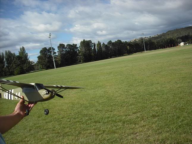

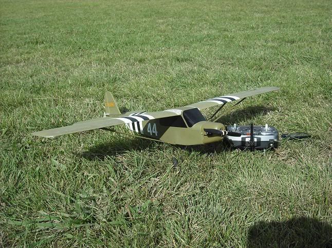

No photos of the contruction project but I did manage to snap these at the field today;
