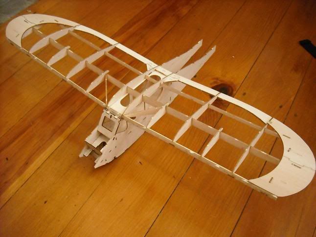

Made a few posts about this a couple weeks ago in the 3D and Sport Planes forums, and the other day the package showed up. Its a new offering from HobbyKing and their first true balsa kit. I got stuck in and heres where I am now:
The HK 3D GeeBee is dead easy to put together and takes me back to when I was a kid, making an Osprey (sic?) from a balsa kit and finishing with a tissue/dope covering. Only needed a sharp knife to trim pieces from the sheets, CA to adhere them and covering film & an iron to finish. No problems with fit at all, although I'd recommend using a 9g servo in the wing instead of the 5g they recommend as it a) fits better and b) will be better able to withstand the aileron flight loadings. 5g are fine for the elevator and rudder.
I've still got to fit all the electronics properly but linkages etc are ready to install after plugging some horns into the control surfaces. The recommended C20 motor fits well once you trim the fibreglass base at the inside edge of the mounting holes, and should deliver over 400g of thrust with an 8 inch prop on 2-cell drawing 10 amps... massive overkill seeing as it'll weigh 220g or so ready to fly.
The plan at the moment is to use this as a regular sport-plane and 3D trainer, as I have no experience with 3D flight except for some mild vertical and prop-hangers on my L4. I mean, I'm alright with loops, rolls (axial/barrel), stall-turns, inverted flight and other sporting maneuvers, but am yet to properly hover and so on. Hopefully I don't wreck the plane up too much learning, any advise would be much appreciated.
Thats it for the moment, more as it happens.

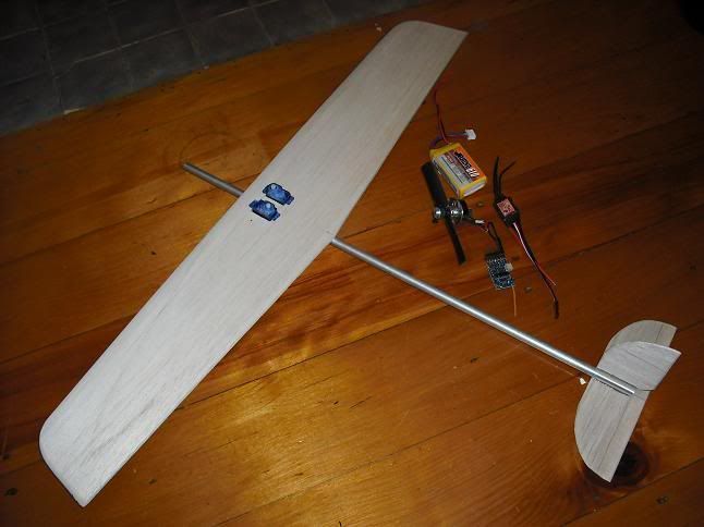

Its been a good couple of days for flying, and now the weather is closing in. Winter is on its way. No matter, last night I roared up the fire and started on the balsa QuickOats 100 from Stevens Aero which was kindly sent by dhdrover. Thanks again mate, much appreciated.
So far the empennage and left wing are together, still waiting on assembling the fuselage and right wing half. The internals are going to be from my Parkzone UltraMicro P-51, which was my first plane. It took an absolute battering and ended up requiring a manual hold of about 30% left aileron and down elevator to fly. Trim was useless as it'd give unpredictable deathspirals at useful levels. Anyway, its organs are going to a better home so it'll live on (ironically, in something that probably would've made a much better first plane).
The L-4 has been fitted with a Hextronik 24g 1500kv motor, replacing the 3000kv version of the same motor that was in there. I'm still running on 3-cell and have fitted a GWS 8x4 direct-drive prop. It works very well, giving huge thrust and moderate airspeed. Hovering is easily possible, as is 0~5mph groundspeed into a wind. I'd estimate the thrust/weight ratio at 1.5:1, which is about double what it was with the 3000kv motor. Efficiency has soared as well - I'm now using around 70~80mAh per minute in flight, so can get 6 minute flight times from my Rhino 3s 610's and 10 minute flights from the Zippy 3s 1000's. Both times factor in only using 80% lipo capacity, too. Nice.
The speed stick I'm working on hasn't seen any more... er... work but I am waiting on some major components like the motor mount and GWS 5x3 props. I'm planning to run the Hextronik 3000kv from my L-4 in it, with Rhino 3s 610's and an 8/10A ESC. Light and (hopefully) fast setup, should be fun.
As always, stay tuned.
