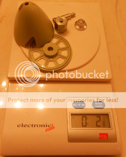

I have already done this motor swap on my new Park Zone P-47 Thunderbolt!
Modifications Details: (Blog)
http://www.rcgroups.com/forums/showthread.php?t=1827219
Flight Results: (Blog)
http://www.rcgroups.com/forums/showthread.php?t=1828087
I could not believe the weight scale on the STOCK Park Zone 15 (950Kv) and the heavy Spinner + Prop Adapter (Large Metal Nut)! Just look!!!
No wonder these models NOSE Over so easily!!!

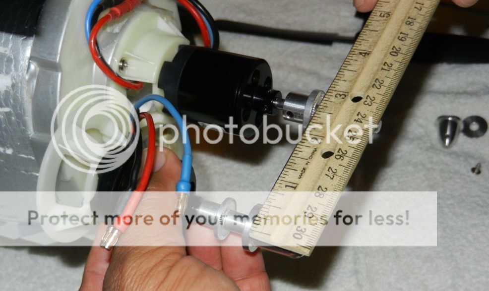

Measuring what length of spacing is needed for Motor Swap

If you are wondering what I am doing switching very capable Stock Park Zone 15 Brushless Motor out from this fine Thunderbolt is because a few people starting to post that the Thunderbolt would not fly using the Park Zone 480 (960Kv) and that it will have just too little airspeed etc...etc.......etc.......so, I took the challenge!
This is to prove that you certainly can install the smaller Park Zone 480 (960Kv) brushless motor (Dr. Kiwi has this motor normalized as a 910Kv motor).
First, if you like to see what I did while using the Stock Park Zone 15 then, please visit this thread:
http://www.rcgroups.com/forums/showthread.php?t=1826517
Also, here is Dr. Kiwi's Normalized Kv for the PZ 480 motor:
http://homepages.paradise.net.nz/bha...rkzone480.html
Okay, I will now discuss the modification done to allow for the smaller Park Zone 480 Brushless motor to be installed on the P-47 Thunderbolt.
Therefore, for those that "are" interested then, here are some pictures showing what Hardware I used for spacers and bolts to allow for a good distance from Firewall and allowing to clear the opening of the Cowling using the PZ 480 (960Kv) Brushless motor and swinging the GWS 4-Blade 10 X 8 X 4 Electric Plastic Propeller.
