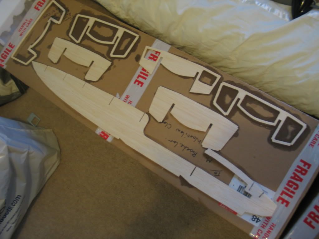

First i had to find some plans, these were supplied to me courtesy of CornelP;
http://www.rcgroups.com/forums/showa...6&d=1291297765
Next was the delicate and the most time consuming job of the whole build and that was to get the plans printed out on A1 size paper by a local printers, then to cut out the pieces very carefully and position them onto the 3.5mm ply sheet, glued them down with paper glue and drew around the templates before cutting out the pieces with a scroll saw.
