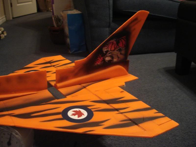

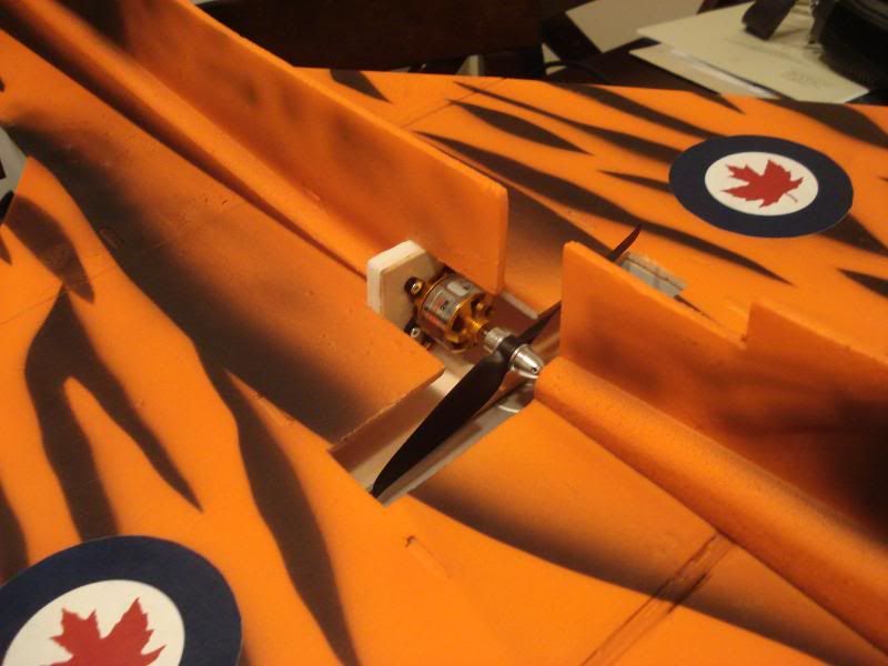

Figured id upload a few pictures of another Plane a good friend Built for me..
I have sense swapped out that geared inrunner,for a 2628 2200kv BL form RCtimer.;0)...Continue Reading

In trying to find a decent Powerplant that was semi efficient!! I needed something that could swing a 8 or 9 '' Prop.
So i decided to give this one a shot!
http://www.hobbyking.com/hobbyking/s...dProduct=14342
If ordering this BL get this. be sure to pick this up as well this BL does not come with any mounting hardware!

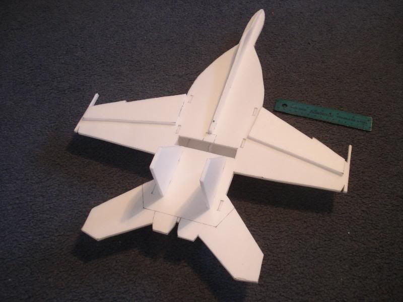

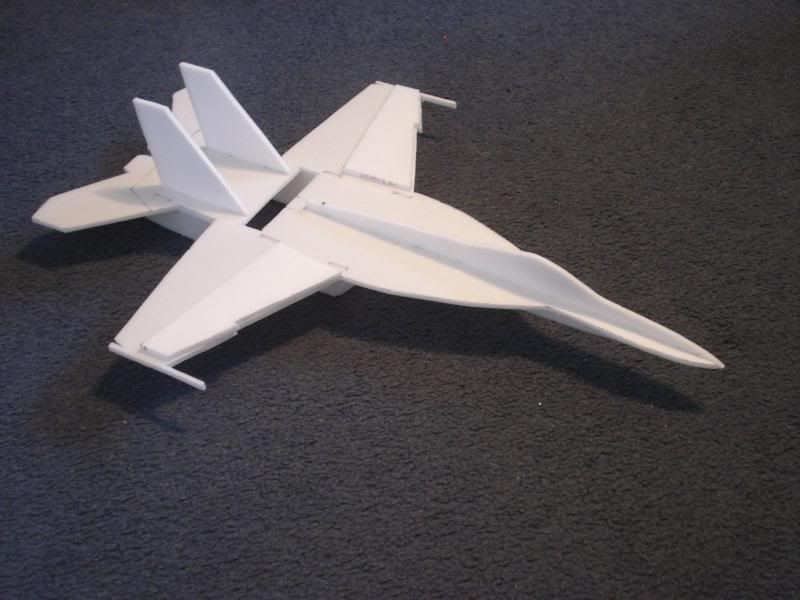

I decided too do a Mini F-18 build as a test build before making the full size version.I well put a Power system in her. Would make for a decent parkfkyer on calm days. Now i need too decide what motor to use.
Heres a few pics of the dry fit with Stick pins.

TomHe's F-18
Designed by Tomas Hellberg
My new build it is going to be another TomHe's line of well designed Aircraft.
http://rc.tomhe.net/fa-18
I haven't decided if i am going full scale yet. But seeing its only 28.5'' i well Prob stay to scale.
I have 3 sheets of 9mm EPP and alot of DSF. My Plans are too round off the Fuse a bit more on this one. Sort of Like the top of my Euro Fighter.
But i have too watch the weight. doubling up dollar store can get heavy if your not careful. Ask me how i know!!
I am also debating Servo-less Re-tracks for the f18. I thought about doing it with the Euro Fighter after i had it built,but i thought it would be better to add them during a build ,verse's cutting up a built model.
Also with the lower wing load of the F18 i well be doing a KFm airfoil haven't decided which yet.
