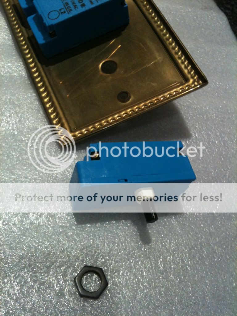

Step 2. Prepair parts.
Remove the dimmer unit from its facepalce and make holes in the project box
do this by pulling the knob off the front and unscrewing a nut behind it, the size and location of the holes in the box will vary...Continue Reading

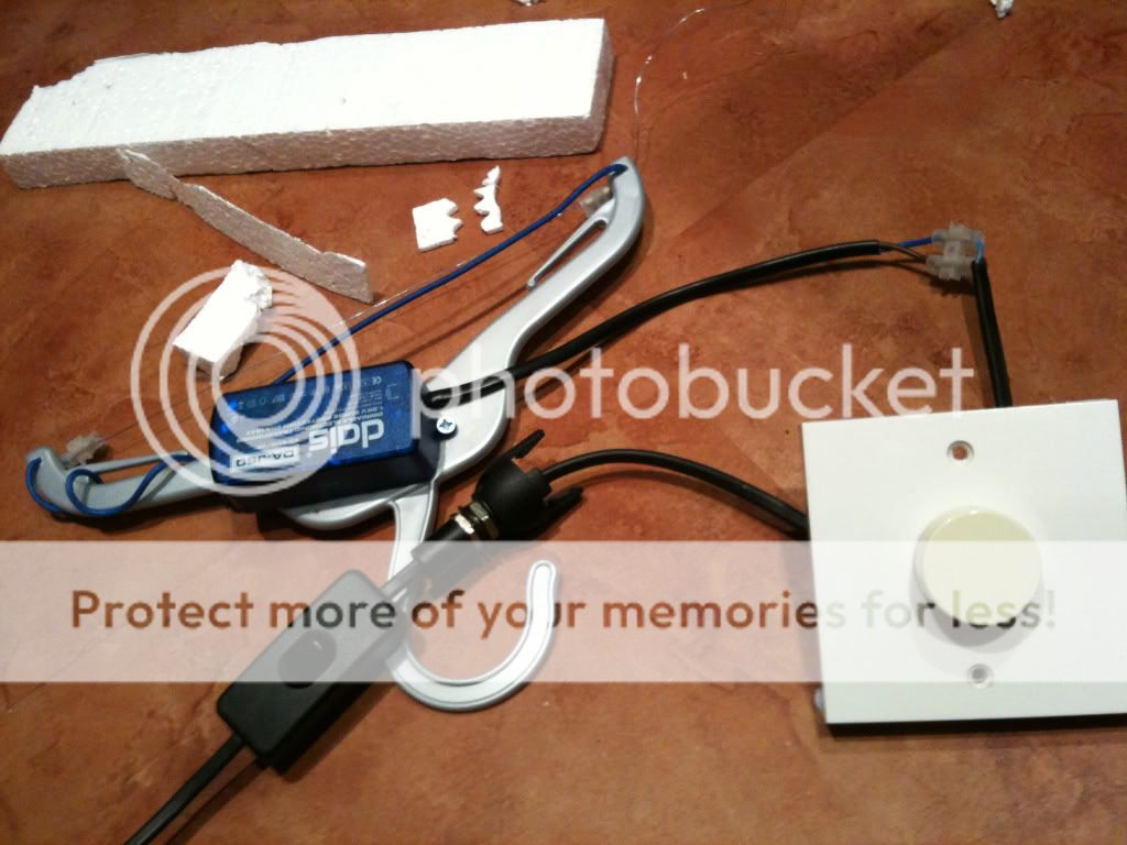

Here's the wire cutter prototype I made a few days ago...
The parts
The NiCh wire is held taught between the two points of the coat hanger by the terminal blocks and is attatched to the 12v output of the transformer, the dimmer switch that would normally dim the bulb is used to control the temperature of the cutting wire and the black in-line switch allows the setup to be turned on or off without having to find the right place for the heat setting again but this is not needed if a push on/off dimmer is used.

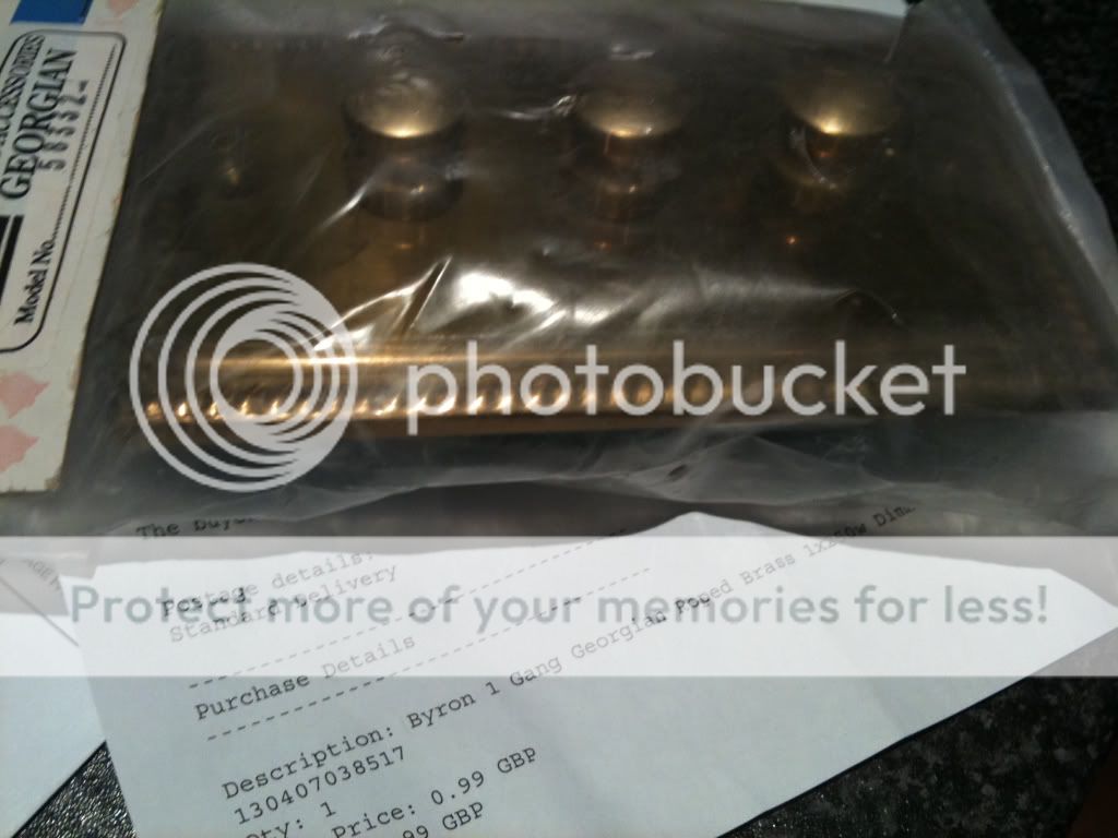

I won a 1G rolled brass dimmer on eBay for the starting bid of 99p with free p&p! When it arrived I opened it to find this...
they sent a 3G by mistake, as it was a clearence item it was ok, so as I only need the unit and not the faceplate, SCORE! now I have 3 units or 99p.

The parts
- 12-18 month childs coat hanger
- Ni-Chrome resistance wire 26SWG
- Terminal blcoks
- Low voltage (12V 5amp/60VA) lighting transformer
- 1G dimmer switch (prefferably push on/off)
- 1.5mm or higher main cable and plug
