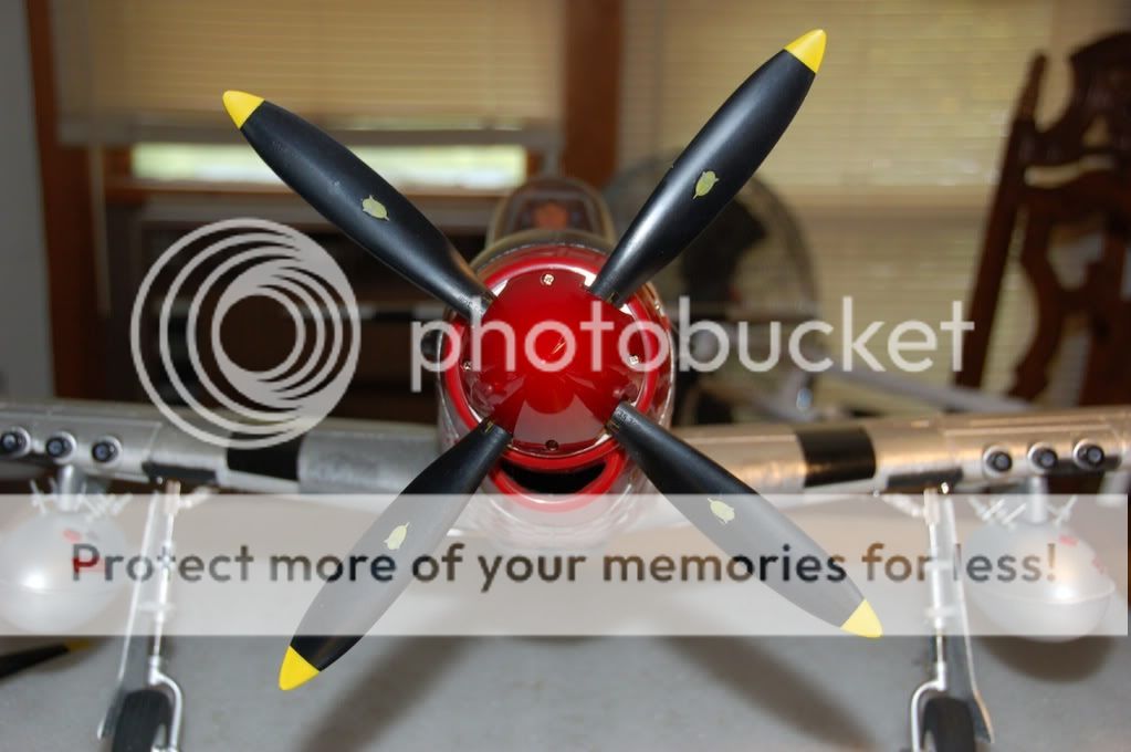

Posted by Sandancer | Sep 18, 2010 @ 05:54 PM | 15,418 Views
Okay! With the motor centered and the Cowl mod completed, I needed to find a 4-Blade prop for the Jug.
The only viable solution I could find was the VarioPROP by Ramoser.
I must say, this thing is Kewl! You can adjust the blade pitch to suit your needs for whatever application you desire. Although not scale because of the spinner, I could run this on the P-51 if I wanted too. It comes with a gauge, pointer and ball headed hex driver to aid in the pitch adjustments. Blades and spinners are extra, but blade replacement is reasonable.
What I have is the 4-Blade 12C adjustable hub suitable for an 8mm prop adapter. The blades recommended for my application with the P-47/580 motor was the 13 x 9 #353-12 (I said 352-12 in the video). These 13 x 9's actually measure 14" from tip to tip. The Dome Spinner is the #1201 aluminum spinner which attaches to the prop shaft with a 3mm countersink tap screw. Because the 580 prop shaft would have to be drilled and tapped to accept this screw, I decided to stick to my SAE standards and went with a 6/32" SS countersink button head set screw (I also have a lot of these in stock)!
TIP:
If you should decide you want to go with a 2-Blade set-up, simply remove 2 of the blades in the 4-Blade hub. With a range of 10" to 15" blades in both "Speed" & "Scale" in the 12C hub, the options are wide open to whatever application you would want to try! Just keep in mind that...Continue Reading

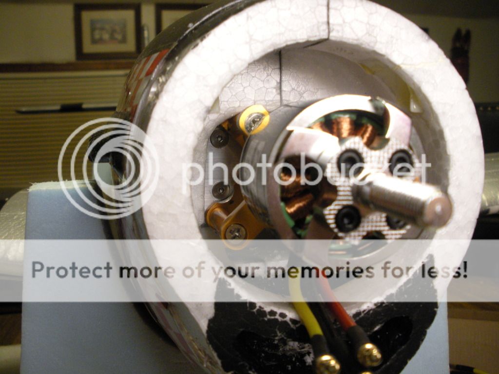

Posted by Sandancer | Sep 18, 2010 @ 04:40 PM | 12,681 Views
I noticed while doing the Cowl mod how severe the motor mount was out of alignment.
To correct this I made a wider firewall mount for the SK 580 motor mount so I could move the whole assembly 1/4" to the left (facing engine), and still be able to use the 2 screw holes on the right side of the firewall. Because I already had the 2 dg. thrust built into the mount, it was simply a matter of moving the mount to the left.
Once done, the prop shaft now exits the engine compartment dead center.

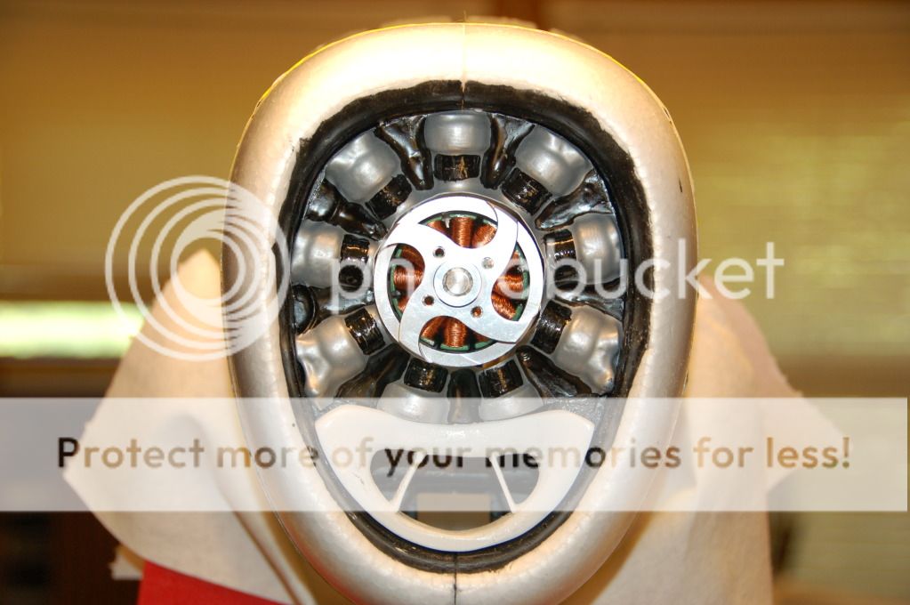

I just couldn't adapt to that "Picket Fence" looking thing FMS was calling their WASP replica, so I set out to try and come up with something better!
My first attempt was a 3 1/2" vacuum formed replica of the Pratt&Whitney 18 Cyl. WASP engine, but I found it to be to small! So I then tried the 4 1/2" replica and it was to big! A 4" would be just right, but I haven't been able to find one, so I got my trust scissors out and made the 4 1/2" fit!
I knew this experiment would get costly if I continued to order these vacuum formed replicas, so that directed me in another direction....vacuum forming my own! I am still in the learning process, but until I get it right, what I have now will have to do.
I also wanted to make an air duct to sit below the engine. I took a piece if 1/2" balsa and started cutting, carving and sharpening it to what I wanted. Once I got the mold/buck/plug, whatever you want to call it, to where I wanted it, I had to cast a mold, and then used 2 part epoxy resin to make the finished duct. I'm not going to get into all of that for now, I'll just let these pics illustrate what I've come up with so far, and I'll update later.
One annoying thing I did notice while I was trying to complete this mod was the radical off-set FMS has incorporated into the motor mount placement of this plane. I solved the issue by relocating the motor mount on the firewall. I have more info on that mod in the...Continue Reading

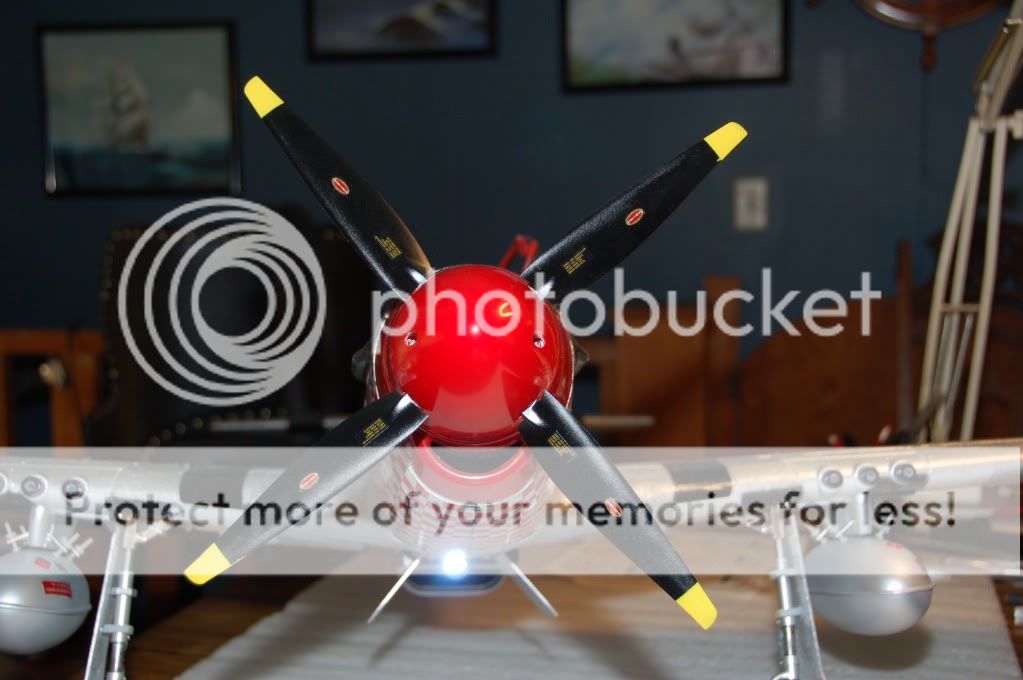

Sticky: P-51D: Props!
Posted by Sandancer | May 08, 2010 @ 10:14 PM | 17,407 Views
Props!
UPDATE 7/16/2012: Since this page was written 2 years ago, I have since updated the aluminum/spinner combo to a more scale 3 1/2"/89mm combo from AirBorne Models.
On some versions, and depending on the chosen supplier, you will get the stock 4-Blade/Spinner combo along with a 2-Blade/Spinner combo. There has been, and IMO, will continue to be an endless debate on motor/prop combination's with this plane. After watching all the pros & cons discussed, I have settle on 2, maybe 3 prop selections.
Of course the scale 4-Blade is a 'gimme. You can't beat the sound it makes flying by 'ya!
My new VarioPROP 4-Blade on the Mustang!
The detailed stock 4-Blade prop on the Mustang.
Note: The FMS 2-Blade/Spinner combo.....the spinner, due to it's thickness, won't fit the SK 42-50 650Kv shaft adapter. By that I mean the adapter shaft is to short to accept the spinner and the prop hub with enough threads to accept a nut. To solve this little ditty, I purchased Tower Hobbies 3 1/4" Nylon Spinner & Aluminum Backing plate. It fits nicely on both the 650 and the 580 with threads to spare.
Up-Date 5/15/2010: This is the method I use to paint the Prop Tips! I use Krylon OSHA Safety Yellow #1813.
UP-DATE 6/13/2010: I thought I would post some 2-Blade options that I have on hand.
UP-DATE 8/04/2010: I just finished detailing the 4-Blade Prop with Spec. Labels & Hamilton Standard logos. See the Decal...Continue Reading

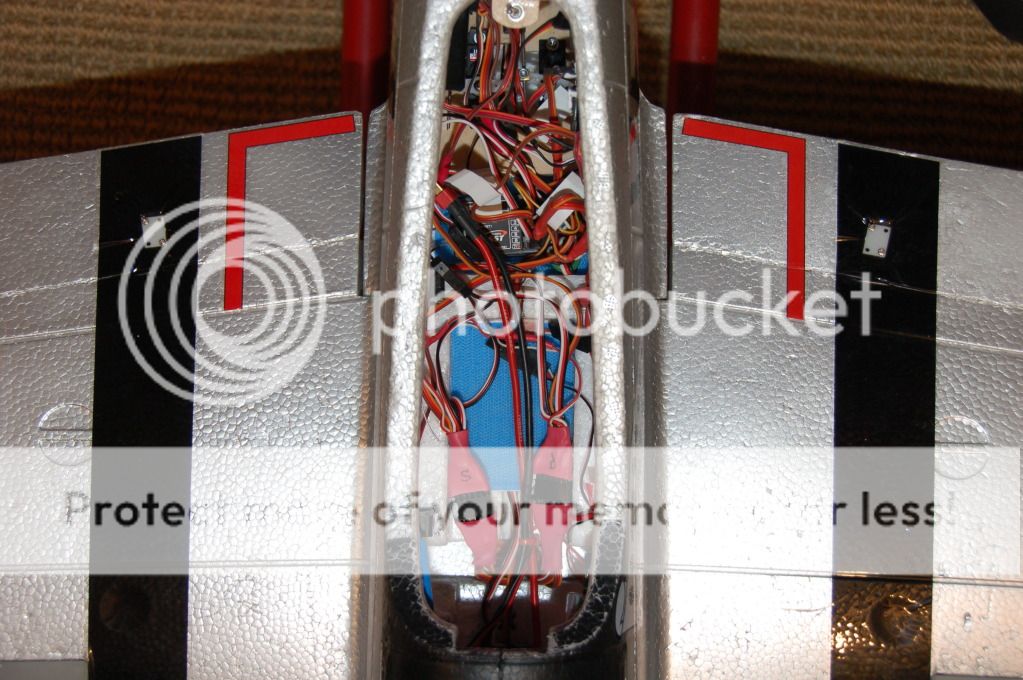

The Nerve System! Electronics!
This is the Electronic set-up in my P-51.
ESC: Pentium 60A w/3A BEC
BEC: Castle Creations 10A
Reciever: Futaba 2.4Ghz R617FS
Landing Gear.............DSR2-46T Titan Electronic Retracts / Titan Tricycle Version
Quanum 2.4Ghz Telemetry System
Navigation Lights.......RC Lander / Hunter series
LG / BD sequencer.....MicroGear
14-Pin Wiring Harness...Futurlec Multiplex Header
Servos:
Elevator....................HiTech HS-82MG
Rudder/Tail Wheel......Hextronic MG 14
Ailerons....................HXT900 9g
Flaps........................HXT900 9g 1 servo reversed.
Bay Doors.................HXT900 9g
NOTE: I don't trust servo extension connectors as they can work loose, so I solder in my own lead extensions to whatever length I need. I also make my own Y-Cables, and in the case of this Mustang I made a 3 wire Y or X (what ever you want to call it) off the BEC lead into the RX. One for the DSR Controller, one for the MicroGear, and one for the Lander controller (See UP-DATES). I also installed a mini switch in the Lander lead so I can manually switch the lights on/off.
NOTE: Here is a diagram from Castle Creations showing the proper way to wire a BEC into your RX. This method applies to all BEC's, not just the CC's.
NOTE: Reverse Servos! Here is an excellent video on how to DIY reverse wire a servo. Unlike the Weller solder gun that NightFlyyer is using here, I prefer a pin tipped soldering iron for more...Continue Reading
