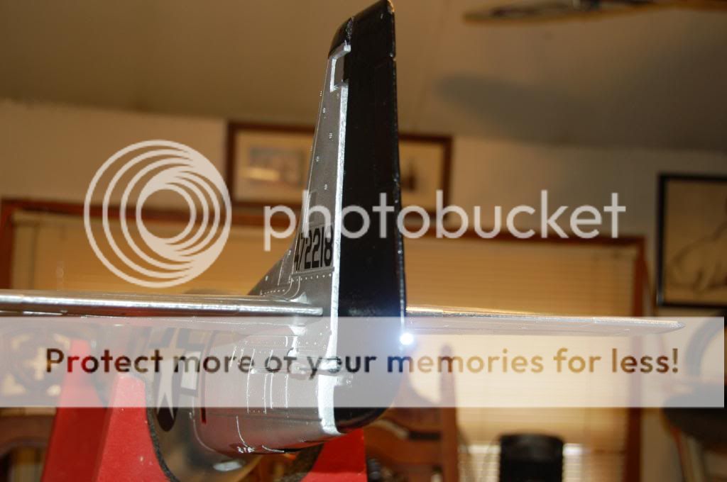

The mods on the BBD's Tail Feathers!
There wasn't a lot that needed to be done on the BBD's tail feathers, but as my nature, I managed to find a few things to mod.
Because FMS has already taken the initiative to adequately install spars in both the elevator and two control surfaces, that mod was no longer needed.
They've also added a joiner between the two control surfaces, which most of us have been doing for a couple years now, which now eliminates the need for two control links running to the control horns.
Another kudo to FMS for these new control horns. They're much stronger, and with the correct screws included, not to mention the nice indexing, they are a breeze to install. They've even included the rubber retainer rings for the clevis as well!
During my re-hinging mod I did discover something new. Usually it's quite easy to slice thru the foam hinging, but on this occasion I found that there was some kind of gummy substance clogging up my knife? On closer inspection it appears that FMS has now added some kind of substance to the foam hinge surfaces to eliminate the proverbial dilapidation that occurs over time. Others have mentioned that FMS has recommended smearing their assembly glue over the hinging now, so I guess that might be what it is? In my case the glue, or whatever it is, was put on before the paint process, so I don't know how it would work over paint?
Having removed all the control surfaces, elevator & rudder, I proceeded...Continue Reading

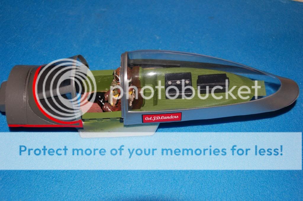

My detailing, modifications, and pilot up-grade for the FMS P-51D "Big Beautiful Doll" Cockpit!
I like the concept FMS has devoted to the sliding canopy/cockpit design. The front of the cockpit itself is wide open therefor allowing a lot of air to enter. With the canopy no longer glued down, there should be enough clearance in the rear for adequate air ventilation thru out the cockpit. The dash panel is adequately detailed.
The pilot is the same guy used in the 1/7 scale 1700mm P-51 and just looks out of scale for the 1/8 scale 1400mm P-51, although he does have a better appearance compared to 'ole "Goofie"! Because the new cockpit requires a full figured pilot, and I had my 1/8 scale AOI WWII US pilot, I decided I would combine the two. The fit between the AOI pilot bust and the lower torso of the FMS oem pilot was almost a perfect fit. Glued together with some paint touch-up, it's hard to tell the dissemblance between the two. When he's seated in the cockpit, you can't even tell.
The canopy locks closed with a couple of ball & sockets located on both sides of the sliders. They making opening the canopy a bit difficult, so I am thinking of adding some sort of pull tabs to help aid in that task? I haven't come up with anything that might work, yet retain a scale appearance yet?
UP-DATE 3/19/2013: After repeatedly installing the cockpit on & off the fuse I started to notice a weakness in the forward section!
