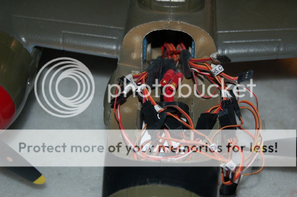

Take my word for it......wiring this plane will take patience, preservation, and a degree in Electrical Engineering, (just kidding).
It's really not all that hard to do, just don't let any of those tags come loose!
NOTE: The original review of this plane on the Nitro website stated that they were using a 4s lipo. FMS recommends a 3s lipo so I am using a 3S 3300 30C lipo in mine. Over time it has been proven to be the correct lipo for this model. DX Stickman/Lee, among others, have reported shorter life spans on the stock motor when they tried using 4s!
On my plane I have 16 leads from each wing, 10 leads coming from the tail, and 9 leads coming out of the nose. Couple that with 3 y-connectors, and 2 tri-connectors, not to mention the ESC leads......I have my work cut out for me.
To simplify the Nerve system and make it less confusing I am once again using Futurlec multiplex Headers. On this system I needed to cover the sixteen leads from each wing so I used a 20-pin Header for both. It does take time to solder each harness together, but in the long run, if I need to remove the wings it's simply a matter of unplugging the two harnesses and the ESC leads.
UP-DATE 2/07/2011: I changed the ESC lead to the XT60 connector, and wired in the CC 10A BEC. I pulled the ESC red lead from the connector and insulated it with heatshrink.
I mounted the Lander Nav light controller and the Microgear sequencer on the inner hull with Super blue velcro....Continue Reading
