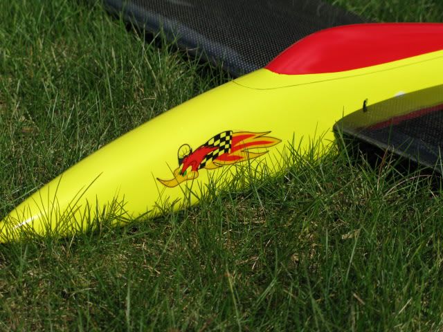

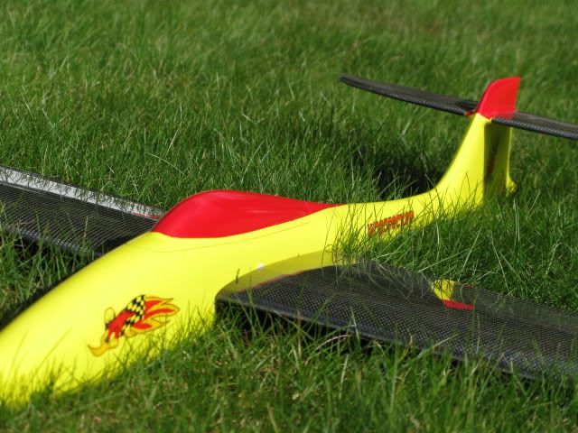

Here are a few photos of my newly completed Joe Cormier 'Woodpecker' as it is ready to fly. Thanks to Joe for a quality build on the fuselage and the flying surfaces. If you are interested in a Woodpecker contact Joe directly on RC Groups at 'joemach1'.
I produce the set of Woodpecker graphics. They are provided as an 8.5" x 11" sheet of stickers. The stickers can be cut from the sheet and applied to the Woodpecker as desired. See the last picture in this blog entry for the complete set of stickers.
Woody died a horrible death on May 21, 2011 when he slammed into the top of Eagle Butte during his maiden flight. Needless to say I am extremely bummed. It's a beautiful flying plane.

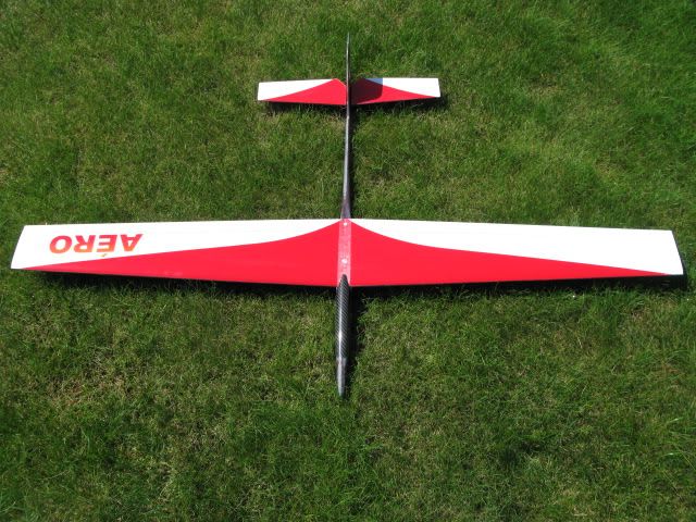

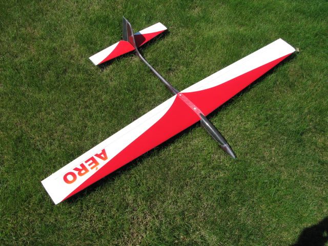

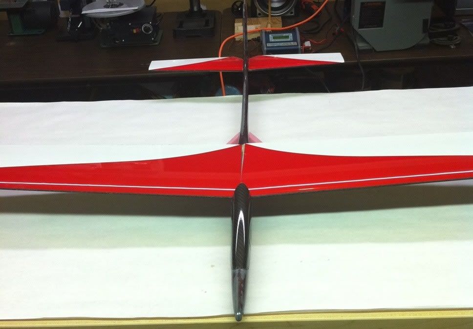

The new AERO 60" Slope Racer prototype is almost ready for its maiden test flight. The fuselage is an all carbon/kevlar fabric with red kevlar, the rudder is all carbon, the canopy is all carbon. The stabs and wing are blue foam cores with 4.7oz unidirectional carbon fulll length and width. Paint scheme is prepainted on mylar with an AERO graphic. Wings will utilize flaperon control surfaces with a kevlar skin hinge. Stab is a full-flying style. AUW=TBD, but at least 36+ oz.
The pictures below are low resolution taken inside my shop so they are not the best quality. I wanted to give you a sneak peak at the progress. Plan is to bring 2 AERO's to the Cape Blanco slopefest in August. This is a prototype so the finish on the fuse and flying surfaces are prototype quality and are not indicative of the final quality version. Enjoy.

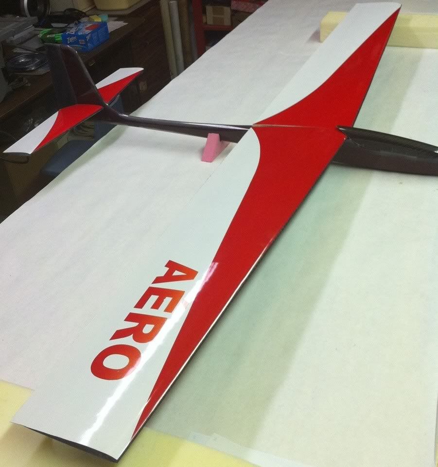

AERO graphic and color scheme pre-painted on the mylar before bagging. Fuselage is made with a carbon/red kevlar fabric.
Shows the thin profile of the fuselage.

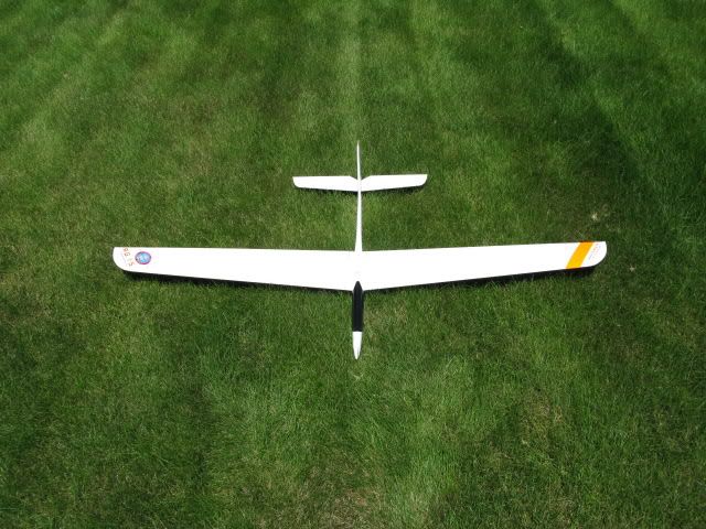

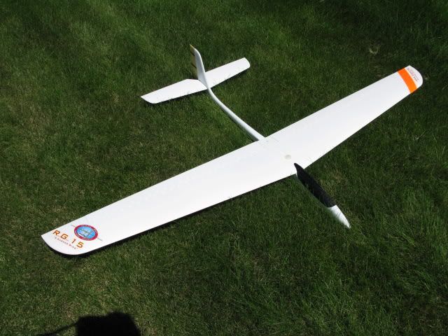

A few photos of my Ridge Grabber 15 based on the AVION fuselage. The layup shown is intended for a 60" competition slope racer. The wing airfoil shown is an RG15, therefore the name Ridge Grabber 15. The AVION has a molded rudder available.
The wing's planform tapers from 7.25" at the root to 2.75" at the tip. Wings are constructed with flaperons which allows the plane to slow down to a crawl when landing. I have built the AVION using the SD7037, SD7032, RG15, and SD7003 airfoils.
  • The AVION fuselage in fiberglass with kevlar and carbon reinforcement retails for $200+shipping. Includes an all black carbon or kevlar canopy.
  • The AVION molded rudder retails for $50+shipping.
  • The AVION fuselage all carbon/kevlar combo layup retails for $250+shipping. Choice of black/red, black/blue, or black/yellow carbon/kevlar layup.
  • Short kit including fuselage, molded rudder, stab cores, wing cores, fuselage plywood parts, and full size plans retails for $500+shipping, or $550+shipping with carbon/kevlar fuselage. A 50% deposit is required with order.
  • There is a 2-4 week delivery time from receipt of order and payment. Ask for current delivery schedule.

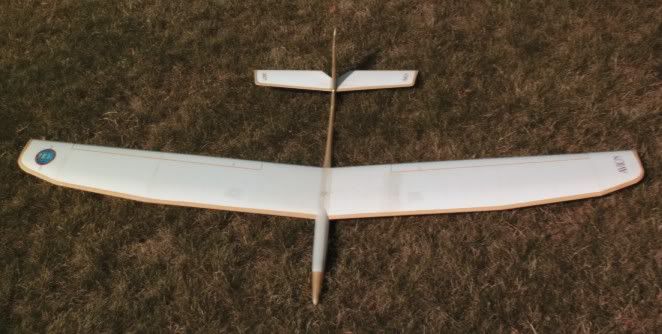

The AVION with an RG15 wing.

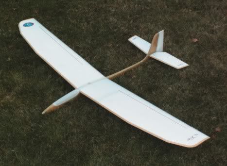

Here are a few pictures of the all Kevlar AVION. It utilizes a one-piece bolt-on wing with triple taper wing planform using an SD7037 airfoil. The stab is an SD8020. Construction of the wing, stab, and rudder is white foam bagged with a light layup of s-glass with a kevlar leading edge.
The fuselage features a removable flight pack which includes 2 servos, a receiver and battery. The flight pack is secured in place with one screw on the underside of the fuselage. A handlaunch fingerwell is integrated into the underside of the fuselage for javelin style tosses.
Functions include ailerons with flaperon functionality, pull-pull rudder, and a full flying stab. Rudder is mixed with aileron for smooth thermal turns or decoupled for light sloping.

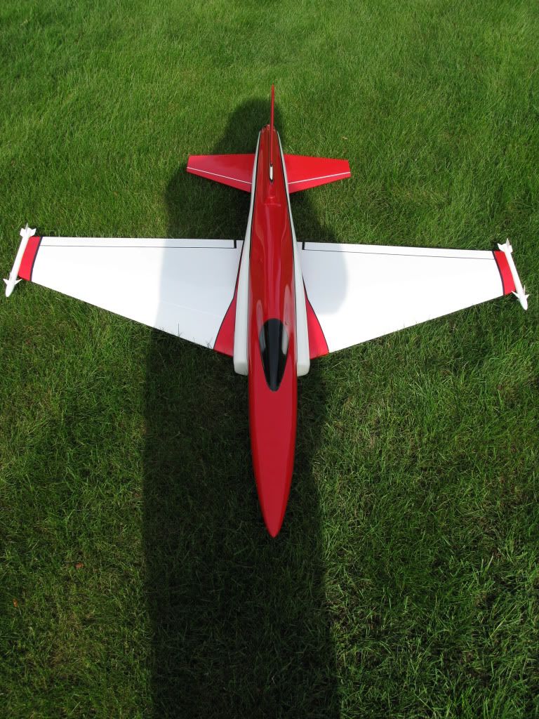

My one and only PSS glider. I think this is one of the best looking F-20's for accuracy of full scale I have seen. Paint job is the official Northrop Grumman scheme. Search on the internet for full scale pictures to compare.
The fuselage is epoxy glass with carbon and kevlar reinforcement. The stab airfoil is a NACA007 and the wing airfoil is an Eppler 205. Wing tip bombs are removable for flight. Intended for static display only.
Flys real sweet in 20+ winds. Short kits are available. Optional airfoils are also available. Utilizes spoilerons for landing control.
