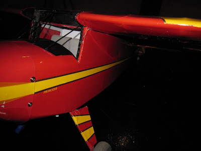

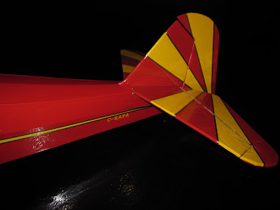

Posted by iRun4Love | Feb 21, 2010 @ 11:07 PM | 3,493 Views

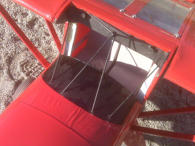

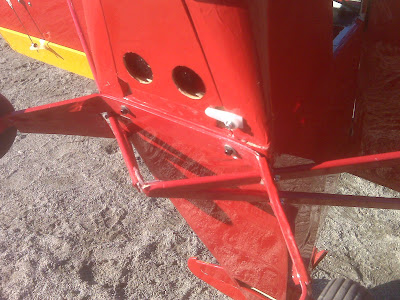

Finished painting inside the winshield and upper cabin area today, and I've included a photo of how I rigged the wing struts after repositioning them half way long the new shorter wings. They are bolted together in the centre with a hinge, and also bolted into the lower fuselage on each side. Quite sturdy, and she fits in the trunk fully assembled too!
Also spent time cleaning up the Monokote on the wings, and added my striping to the horizontal stabilizers and upper wings. Really pleased with the results, and it looks fantastic while mad-rolling in the sky!

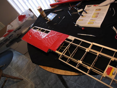

Posted by iRun4Love | Feb 21, 2010 @ 11:03 PM | 3,420 Views
Finally got some time in the "hangar" to get on with the Taylorcraft rebuild. Nothing like a bit of work, family time, and the Winter Olympics in my back yard, to distract me from a re-build!

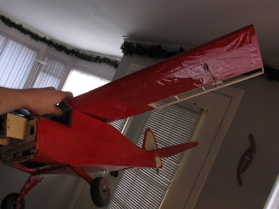

Anyways, I finally got some time to myself, and after finding a few minor broken struts that I had missed on Day One, and after replacing the remaining missing wing struts that I had cut out but not installed, it was time to tackle the re-covering. My hobby store was out of Ultracote, so I had bought Monokote, and watched some online videos about how to apply it.

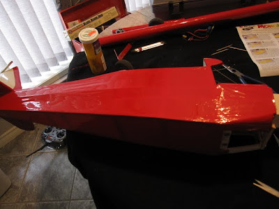

As per the instructions, I started by covering the bottom of the fuselage, then the sides, and then the top. The iron I had was a bit of a challenge to work with, but after an hour or so, I seemed to have things under control - though I was not pleased with the amount of wrinkling that resulted.
After I got the fuselage done (yes, I will cut out the windows later - the local hobby store has had to send THREE window sets back to E-Flite due to damage in the mail, so for now I'll leave them covered), I started work on the wings.
My first step was to insert some carbon rods down the center spars of the wing for extra strength. They came out of my "in-a-zillion-pieces-cheese-shredder" Seafury - one of the only things to survive that disaster crash, so I figured they'd suit me fine in the Taylorcraft.
After that had all dried, I covered the underside of the wings, then as luck would have it, I ran out of Monokote! Will have to make another trip to the hobby store!

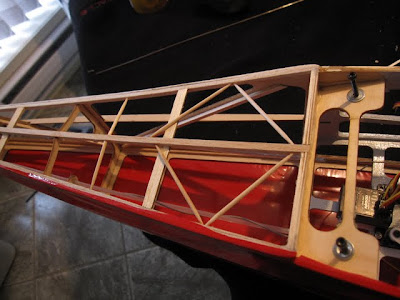

Posted by iRun4Love | Feb 21, 2010 @ 11:02 PM | 3,371 Views

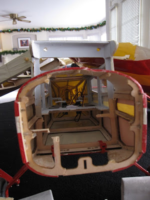

Began today by stripping the covering off the fuselage and cabin area. Left the windshield area alone for now. Found that there were a lot more broken spars and joints than I had first thought. Nothing serious, but probably a dozen patch jobs and joint/spar reinforcements from tip to tail.
The landing gear had taken a bad hit and bent the "A" frame the wheels are bolted to. Nothing I couldn't bend out, but I had to also re-inforce and re-build the lower fuselage where the landing gear attaches. Managed to add a couple beams to reinforce the battery area (which also stabilized the cockpit floor), and managed to salvage most of the engine mount in the rebuild of the area forward of the firewall.
Pictures from Today
Engine mount and firewall drying
Fuselage stripped and drying

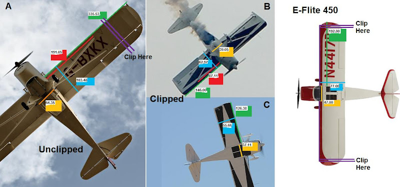

Posted by iRun4Love | Feb 21, 2010 @ 11:02 PM | 3,446 Views
Well I took the liberty of assessing some online photos to try and use my trigonometry skills to determine clip lengths. This photo demonstrates what my math came up with, which is pretty close to my first guess of cutting off straight at the wingtip where it starts to curve (actual math showed slightly further out on the wing but I don't think 2-3cm will make a big diff).
This should start as my Friday project, and I agree - I'll be reinforcing the wing and leading edges and the spar. Overall I'm stoked about what it will turn out like.

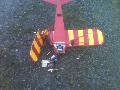

Oh fer Pete's sake! GRRRR. Made the mistake of re-covering the top of the wings all red, and then flew in cloudy skies and didn't take the appropriate time (i.e. DAYS) to get aquainted with which end is now "up" on my rebuilt Taylorcraft.
Came in for a low roll, and pulled down when I should have pulled up. At least I avoided the duck pond, AND the wreckage wasn't spewed everywhere, AND I didn't break the engine, ESC or the Lipo, AND everywhere I had previously repaired was NOT where it broke this time (well, except the engine mount and firewall). Oh, and did I mention, since the new cowling and windshield hadn't arrived yet, I didn't toast new ones of those either?
Yeah, I know - people tell me I'm the eternal optimist. Though I had to tell myself that a few times before I gathered the bits and put them in the CAR and not the TRASH.
First two pics are of the actual crash scene... untouched from my phone cam. Last two pics are after moving it to the car (I had to drive 3 minutes to find it LOL), and stripping off the damaged covering on the wing.

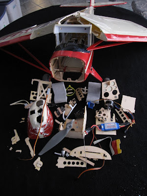

Many moons ago, I had a catastrophic failure of my AR500 receiver in my beloved E-Flite Taylorcraft. Post-crash analysis never did narrow down whether it suffered an un-bind or brownout event. Either way, I took off, climbed 15 feet, lost all servo control, and the TC nosed down at full throttle.
I packed up the bits, dug the engine out of the ground, and put it all in a box in storage. It took a long while for me to even consider attempting a rebuild, but thanks to encouragment from many members of this board (ATIS, CyberJay, Magic2K - in particular), I decided it was time to pull out the bits and assess what it would take.
DAY ONE
After pulling out all the carnage from storage, I was more hopeful than on the day of the crash. So that's something, right?
The Carnage, missing firewall, and wishbone wings...
