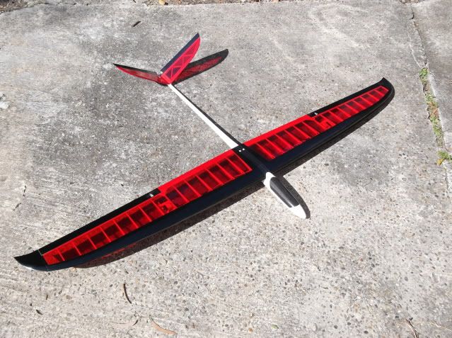

A light glass burner with Hyperion Ds095's. 1.2 kg
A heavier Carbon layup with MKS 6125'S. 1.8 kg

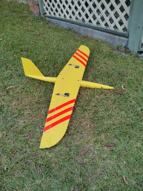

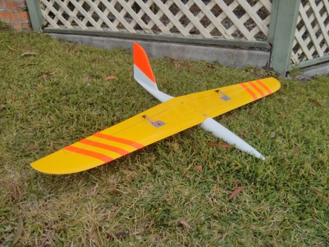

My Stinger 45 is reborn.
I plowed it into some shrub at 85mph DS'ing last weekend,Popping the tail off, breaking the nylon wingbolts and cracking the wing where i had completed a poor repair last year.
I glassed top and bottom inboard of the aileron cutouts, Now its very strong and ready for more punishment. The tail glued back on easily with some thin CA and a pipette. Painted the fuse/tail/wing with rustoleum spray paint and im quite happy with the finish.Colour and stripes is with vinyl.A couple of new 45HB servos for the wings and i call it done.Ready for a remaiden at Manilla slopefest.
The stinger is my favourite plane,It goes with me on every slope trip. At 45 inches the wings never need to come off for transport.If i could only pick one plane for slope use this would be it, It flies well in light lift right through to the heavy days.I love it so much i have ordered another just so i have a backup.

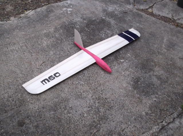

R2 hobbies Passer is ready for maiden. AUW is 560 grams or 19.75 oz, a little heavier than i would like. The kit quality is fantastic with a nice strong fuse and excellent covering job.I used HXT900's in the wing and HS55's for the vtail, an AR500 rx and 4.8v 800mah AAA Eneloop pack. I fitted the tow hook at 1/2 inch in front of CG.Looking forward to throwing this off the slope and high-start.
M60

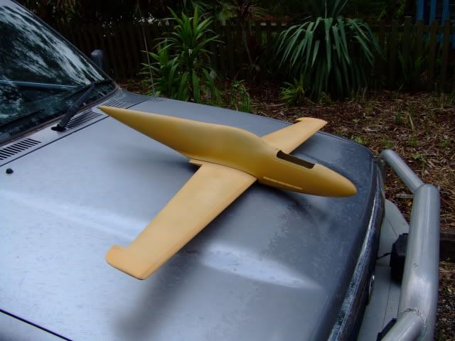

Well the M60 that was started at last years slopefest is almost done.
Im not happy with the hinge job using blenderm so i need to redo them with something better.Also it needs final balancing.

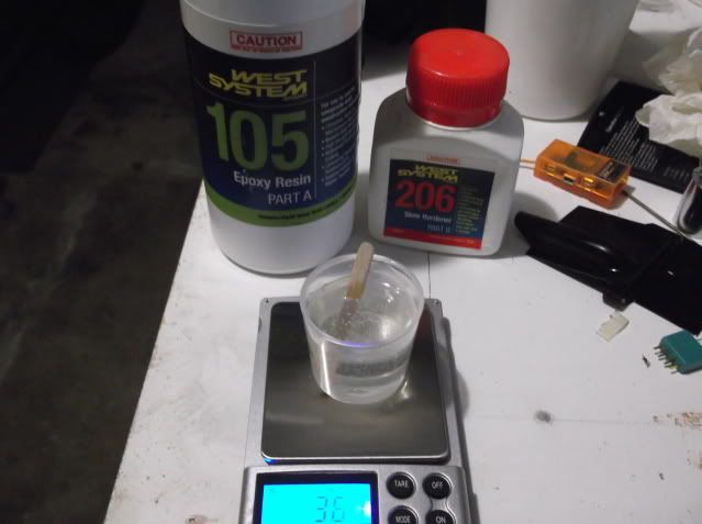

I have opened up the wing saddle quite a bit so i can centre load the ballast tube and reinforce the saddle with carbon tow.
So i mixed up some resin
And added tow and 2oz glass to the saddle and in the canopy and nose.
I really need to buy a roller but i did the best i could with an epoxy brush.
