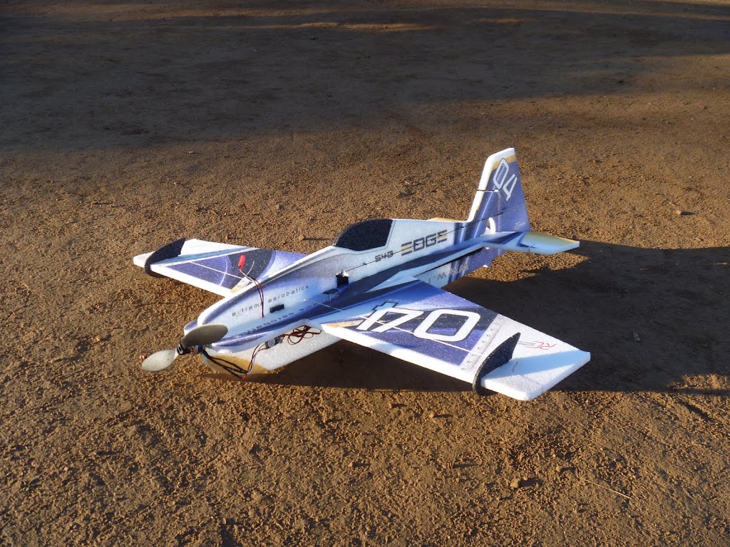

RC Factory Edge 540 at Rancho San Antonio
I had a lot of fun maidening the Edge 540 the morning of 11/19/2011. It's a very responsive plane that has great pull out when you need it. I'm still trying to dial in the CG with my Turnigy 500 mAH 2s batteries at 37g each.
