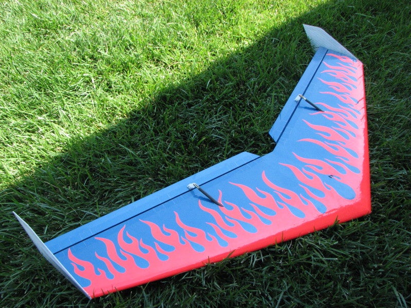

Posted by 1000MPH | Mar 21, 2013 @ 05:02 PM | 8,440 Views
bee weights
2.4oz Wing cores ea
4.7oz total
.36oz ribbon spar
1.57oz Servo HS-325HB
3.14oz Servo x2
.47oz switch
.54oz Electron rec'r
1.97 oz AAA batt
11.18oz w/o glue
12.0 W/ all gear installed
13.2 after fully spackled and ready for thinned goop
13.7oz 1 coat of goop top and bottom before tape
14.1oz 2nd coat of goop in front of cg
13.9oz after 1 day drying
15.9oz 1 layer of 3" on bottom only. new tape pattern
17.7oz fully taped
18oz with extra extreme tape on LE. cg forward
cg at 7"
18.2oz thinned goop on bottom
19.2oz bottom covered w/stripes
20.6oz top covered w/o decorations
20.9oz w/ flames
.30oz ea Winglets
1.01oz ea elevons with one layer of 3M extreme, thin goop, monokote.

Several people have asked how I do my flames...
The top is covered in one solid color and then the flames are cut out of Monokote or Ultracoat and added. I grabbed a gif from an r/c car site a while back and I modified it in PhotoShop (scale, skew) to suit my needs. Ultracoat is easiest because you can easily transfer the image to the paper backing. With Monokote it's best to 3m77 the stencil to the backing and cut around it.
It takes only about 1/2 an hour to cut out one wing.
Apply the flames in one piece (per wing) very carefully using the lowest heat setting that will activate the adhesive. Start near the leading edge and work along it. You can go back and adhere the flames then turn up the heat and seal really well. The Fluoro Monokote always makes an ugly gluey mess. Clean up with acetone.
