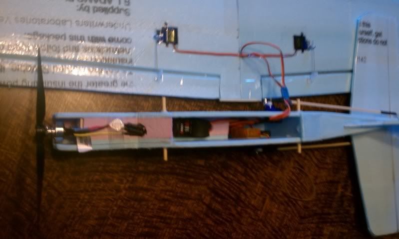

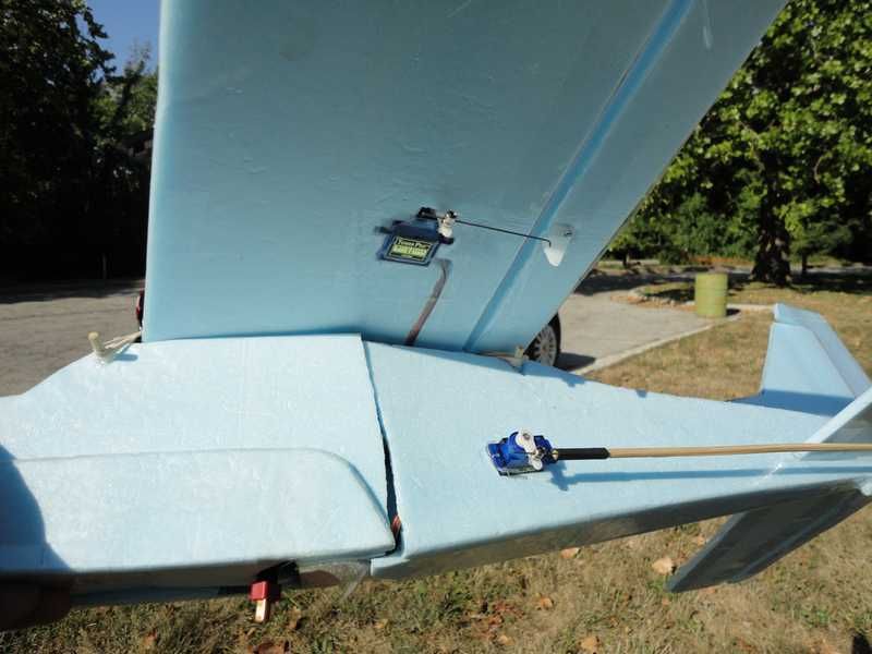

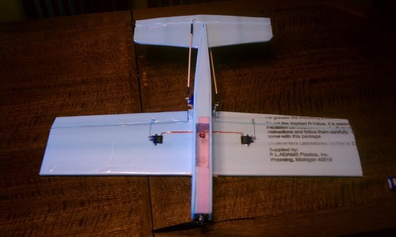

Servo installation
What can I say? I'm a hot glue and bamboo kind of guy. Throw in a little .032" music wire and shrink tube and I'm good to go for servo install. (I also had to run to the hobby shop for servo extensions.)
I standardized on 2" long pieces of .032" music wire and hot glued 1" to pieces of bamboo cut to the appropriate length. A quick bend on one end for the clevis keeper and straight on the other for the servo adjuster. Then the whole thing gets covered with shrink tube which re-melts the hot glue and perfectly encases the wire.

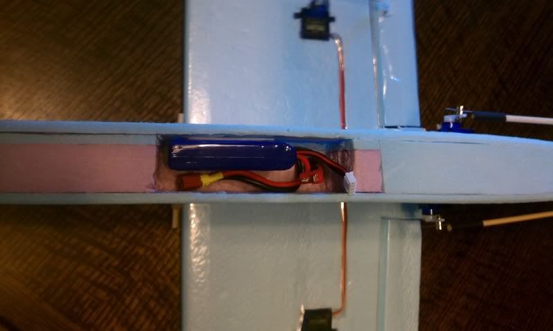

Electronics and Hatches
I like rare earth magnets. I love the feel of the hatch jumping out of my fingers and securing with a satisfying dull click. I used little rare earth magnets in the hatches and short #10 wood screws secured in the fuse with a little hot glue.
The forward hatch with the soon to be ESC velcro'ed in. The battery connector wires were to short coming out of the ESC so I made an extension wire from 8" pieces of 14AWG battery cable. I used female 3.5mm bullet connectors on the ESC end and a dean's connector on the battery end. I probably should have used deans on both ends but headsuprc sends mating connectors with their motors and ESC and I had the set already lying there on the bench. (Besides, the bullet connectors fit nicely under the wing leading edge center skewer.

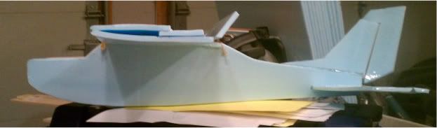

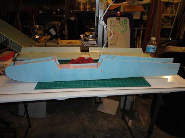

Wing Fitting and Fuselage Install
Before I glued the fuselage sides on I cut up some small 1/8" thick plywood pieces with notches in them to cradle the leading edge wing skewer. I just notched out the monoblock and hot glued them in place.
Then I predrilled for the wing retention lugs (skewers) and used them as alignment pins when I hot glued the fuselage pieces to the sides of the monoblock. I then ran a bead of hot glue down all the sides of the exposed skewers for a good bond where there were voids in the monoblock.
Note: I think hot, gluing the fuselage onto the monoblock was a mistake. There was too much surface area to cover before it began to cool. When I do it again I will use white Gorilla Glue.
I then cut out the fuse bottom and used it to help the alignment. I was very, very careful to make the fuse perfectly straight with the monoblock.

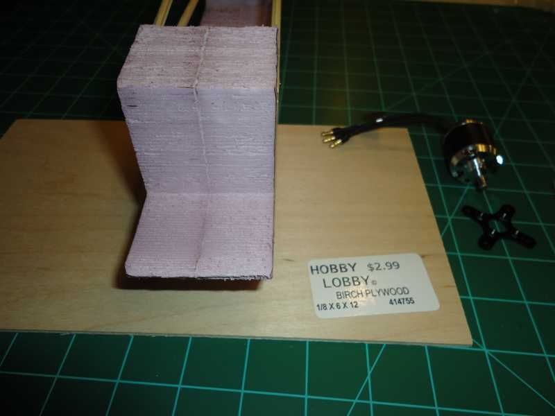

Firewall Construction
With all the skewers in place, I figured it was time to start in on the firewall so I can get that motor mounted.
I cut out a square of 1/8" plywood to the correct size, marked the center by drawing an "X" from the corners, used the motor mount as a template for hole location and drilled the holes for some #4-40 blind nuts to mount the motor.

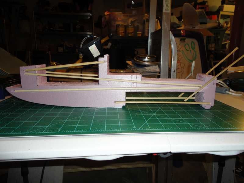

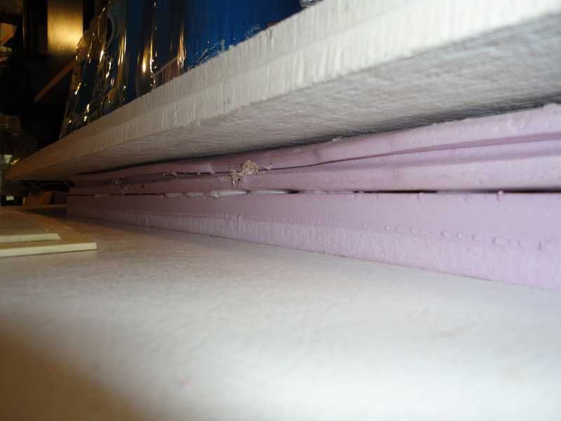

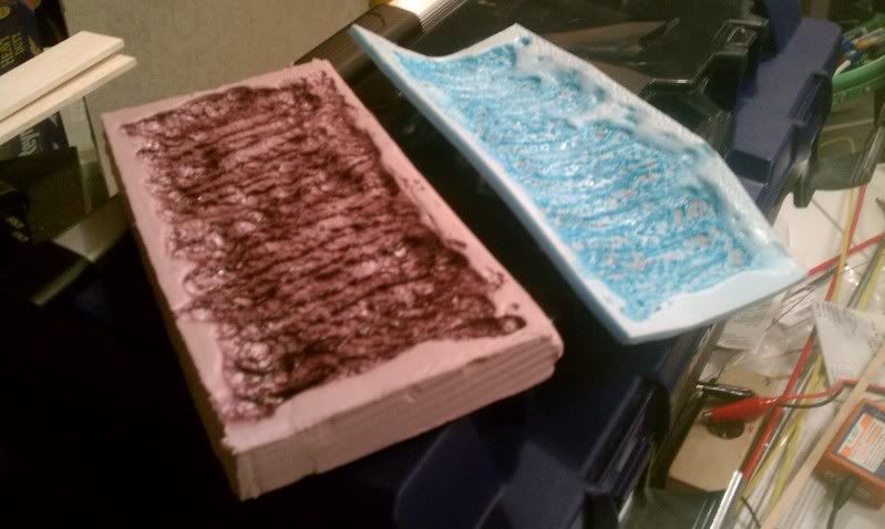

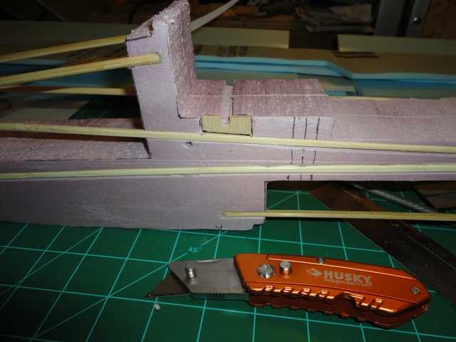

The Monoblock
I had some 1" thick foam in the garage already because I use it on the floor to break down plywood sheets with a circular saw. I started out by cutting two pieces of 1" thick pink foam that were big enough for the monoblock and canopy block.
I brushed them off, wiped the two joining surfaces with a lightly damp paper towel, laid down a good amount of white Gorilla Glue, stuck them together and put some scrap concrete boards on top (leftover from a bathroom remodel...they make a great fire-proof lipo battery charging platform).

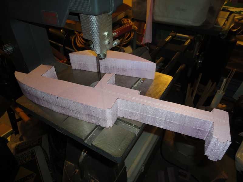

After letting them dry for about 2 hours, I traced out the pieces and took it over to the band saw and cut it out in a flash.
I used a coping when I built my Blu-Baby and I ended up with crooked cuts which resulted in a lot of sanding. The band saw made nice straight cuts. It's a pretty rough cut line, and I'll still have to do some sanding just to smooth it out, but at least I won't be trying to straighten it out at the same time.
With the monoblock cut out, it was time to add the reinforcement skewers. I wanted to try the "doubled up hacksaw blade" trick, but didn't have any hacksaw blades on hand so I used a coarse triangular file to cut a straight groove and then rounded out the bottom with the round file. I was careful to make sure that the skewers...Continue Reading

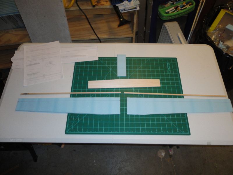

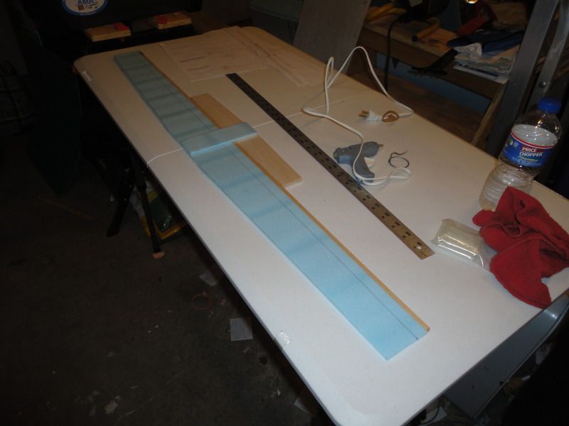

Wing Construction
I spent an evening constructing the wing as a first step in the project. I used hot glue for all the joints instead of the PU called out. We'll see if it comes back to bite me later.
I started by cutting out all the pieces for the inner wing and laying them out to make sure I knew how everything went together.
I glued the spars to the front of the inner panels, glued the two halves together in the middle and added the wood stiffener and foam joiner piece.

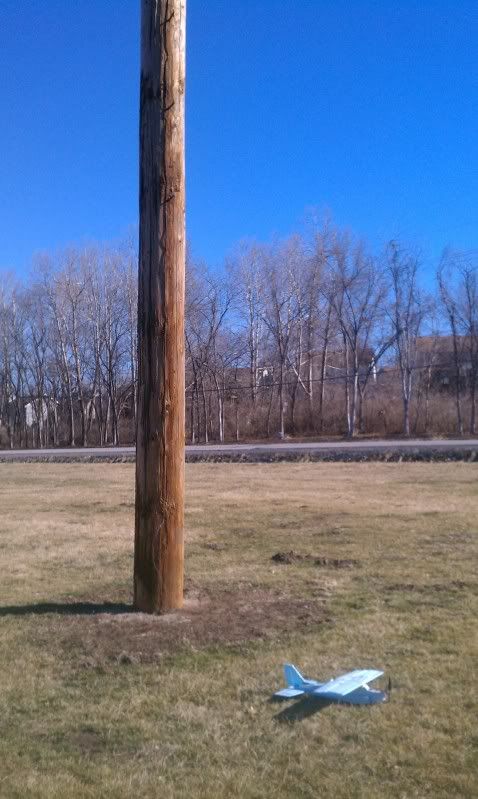

Two minutes into my 2nd battery pack I smacked head on into a light pole at a little over 1/2 throttle:
The right hand side of the fuselage cracked right behind the monoblock...
...the motor mount shifted to provide me with a little more down and right that I originally set it to...

The Crash
So I decided to sneak out for a bit on Saturday morning for a little stick time. I had about two minutes left to go on my first pack and decided to do some low, slow and level coordinated turns...when all of a sudden a huge light pole jumped out in front of my BB32 and hit the wing.
OK, so the pole did not actually jump out in front of the plane. But I didn't dumb thumb it either. The crash occurred strictly due to my lack of depth perception...I couldn't tell if I was in front of, or behind, the pole. It turned out it was neither.
The Damage
It was a pretty slow speed impact, but it still did a number on the plane. You can see how the wing shifted on the rubber bands by the impact.
  • Separated the battery bay sidewall from the fuselage a little
  • Minor ding in the left wing's leading edge
  • Firewall fell off and left whole motor and prop dangling by the wires
  • Cracked the fuselage behind the trailing edge of the left wing behind the bulkhead
  • A little bend in the trailing edge of the wing in the center

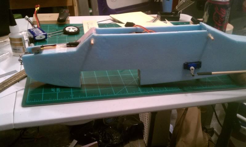

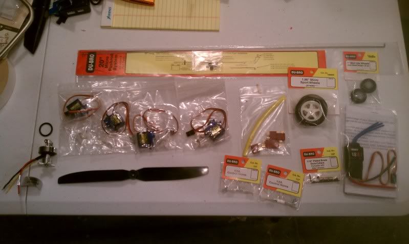

Power System Installation
With the airframe built and the motor mounted, there was nothing left to do but install the different components of the power system. I spent about 3 hours all total getting the power system installed and set, but this is my first build, so had quite a few head scratching moments that I needed to work through.
ESC and Receiver Installation
I drilled a hole with a 1/2" drill bit through the monobloc angling down toward the ESC shelf in the monobloc. It made a bit of a ragged hole, but I'm not terribly worried about this plane being pretty. I then drilled a hole through the back of the battery bay up to the ESC and attached the ESC to with some Velcro.
The receiver install was a piece of cake. I just used the same sticky backed velcro strips I used for everything and mounted it on the inside of the fuselage, rearward of the monobloc.
Elevator and Rudder Controls
I attached control horns to the rudder and elevator and cut a hole in each side of the fuselage forward of the rear bulkhead and hot-glued in servos. I made control rods using .032" music wire, CA glue, 1/8" bamboo skewers and shrink tubing. I used z-bends on the control horns and adjustable linkages on the servo arms.
Note: I had to drill out one of the holes in the servo arms to install the adjustable linkages. I used blue loctite on the tiny little nut to keep it from working its way loose and a tiny dab of CA on the servo arm screw.
