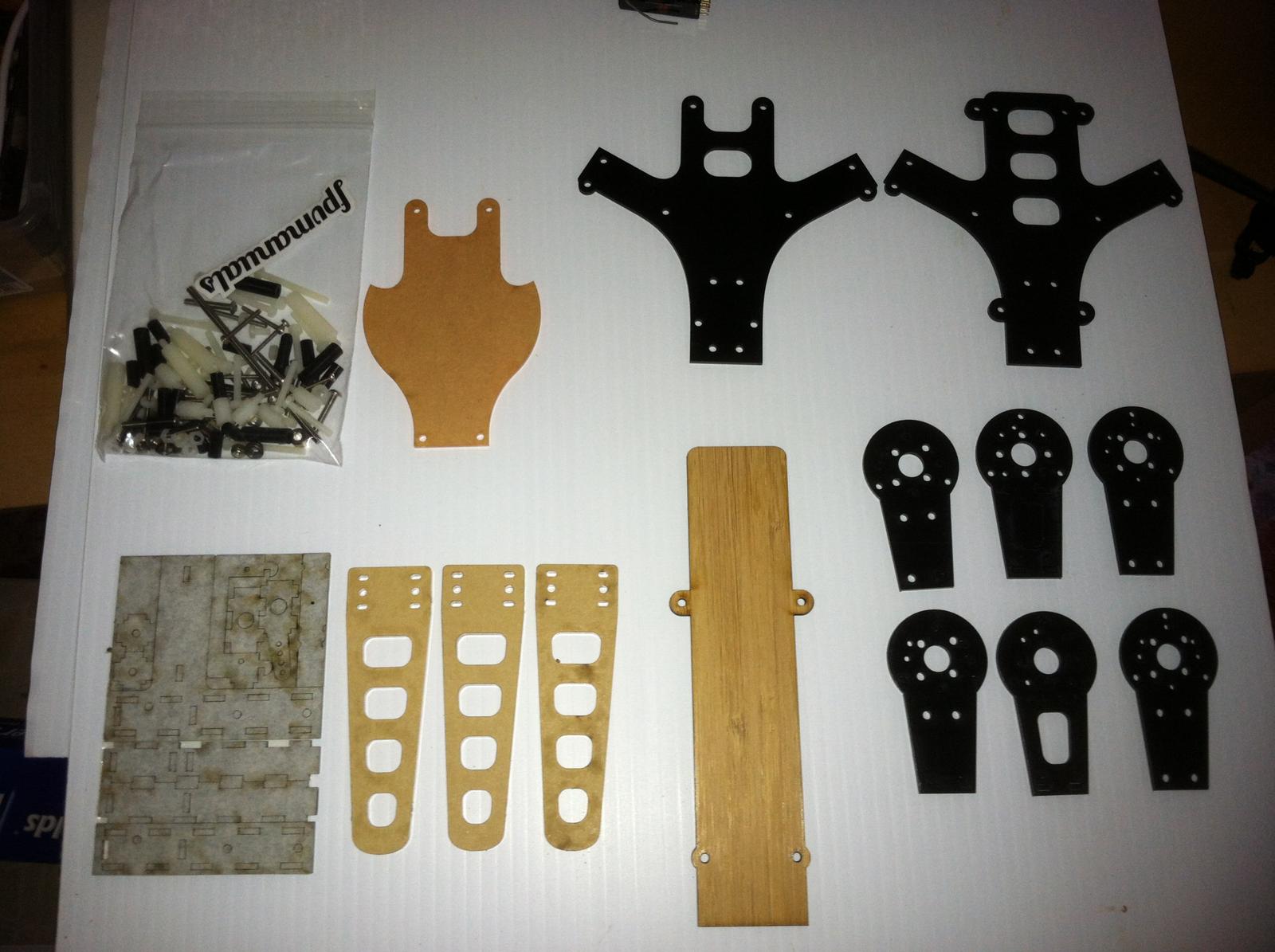

Build Log of Nick_P's Spider Quad
This will document the build process of Nick_P's Spider Quad and contain any information that will help me with the whole build process.
Parts List:
Frame Material and Hardware;
1. Qty 1: 1/8” Birch Plywood from Michaels http://www.revell.com/wood/birch-plywood.html
2. Qty 3’: 1/4” x 1/8” Delrin Tube http://www.mcmaster.com/ part# 1830T119
3. Qty 1: 3mm Drill Bit http://www.mcmaster.com/ part# 30565A249
4. Qty 1: 3x25mm Cap Screws http://www.mcmaster.com/ part # 91239A126
5. Qty 1: 3mm Nylocks http://www.mcmaster.com/ part # 90576A102
6. Qty 2: 1/2" Poplar Square Dowel Rod http://www.homedepot.com/h_d1/N-5yc1...&storeId=10051
Electronics:
1. Qty 4: F-30A or F-20A ESCs http://www.hobbyking.com/hobbyking/s...C_3A_UBEC.html or http://www.hobbyking.com/hobbyking/s...C_3A_UBEC.html
2. Qty 4: Suppo 2212/11 1200kv http://blueskyrc.com/index.php?main_...products_id=38
3. Qty 1: Multiwii Flight Board http://www.valuehobby.com/multicopte...rol-board.html or http://www.rctimer.com/index.php?gOo...1&productname=
4. Qty 1: FTDI Programmer http://www.valuehobby.com/multicopte...rogrammer.html
5. Optional for Camera Tilt Qty 1: http://www.valuehobby.com/radio-syst...ini-servo.html
6. Qty 2: GeForce 2200mah Lipo http://www.valuehobby.com/power-syst...1v-lipo-2.html
Accessories:
1. Qty 4: 8x4.5 props http://www.valuehobby.com/multicopte...pter-prop.html
2. Optional for Camera Tilt Qty 1: http://www.hobbyking.com/hobbyking/s...t_L_Size_.html
3....Continue Reading
