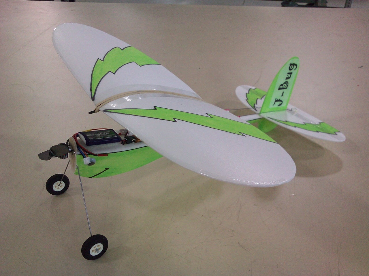

Posted by dz1sfb | Dec 05, 2013 @ 08:18 PM | 14,870 Views
This build log has been a long time coming and hopefully will be helpful to those building my kit of JimmyJFlyer's J-Bug. This is a work in progress at this point.
Kits are available through my website at http://www.kenscadmodels.com/j-bug.html
Adhesives
- Bob Smith Ind. Foam Cure
- Thin CA
Tools Required
- Hobby Knife with #11 blade
- 1" wide Blue Painters Tape
- 8" Sanding Block with 100-150 grit paper
Written Directions
Recommended Sequence
1. Carbon Fiber Installation
- Install all carbon rods in foam parts except for wing rubber band dowels.
Tip - It is easier to leave the parts in their carrier sheets until needed. This protects the parts making handling easier and less chance of damage.
2. Fuselage Doublers
- Remove Pylon Doublers and Fuselage Spine Doublers from carrier sheets. These have corresponding cuts to allow fitting to one another. Glue one Pylon Doubler to one Fuselage Spine Doubler. Make 2, one right, and one left. These then get assembled to the vertical fuselage/pylon panel.
3. WIng Assembly
- Gently block sand the wing root on the preformed wing panels, just enough to provide a flat butt joint. Once accomplished, glue the wing joint and use a piece of tape to hold the joint together while the glue cures.
4. Firewall / Landing Gear Assembly
- Remove all necessary plywood parts from the laser cut sheet for the firewall and landing gear. I use CA glue to put these parts together.
5. Horizontal Fuselage Panel
- Install horizontal...Continue Reading
