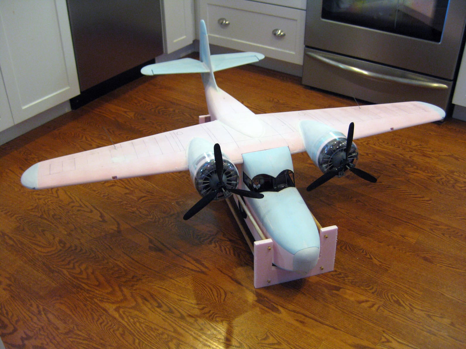

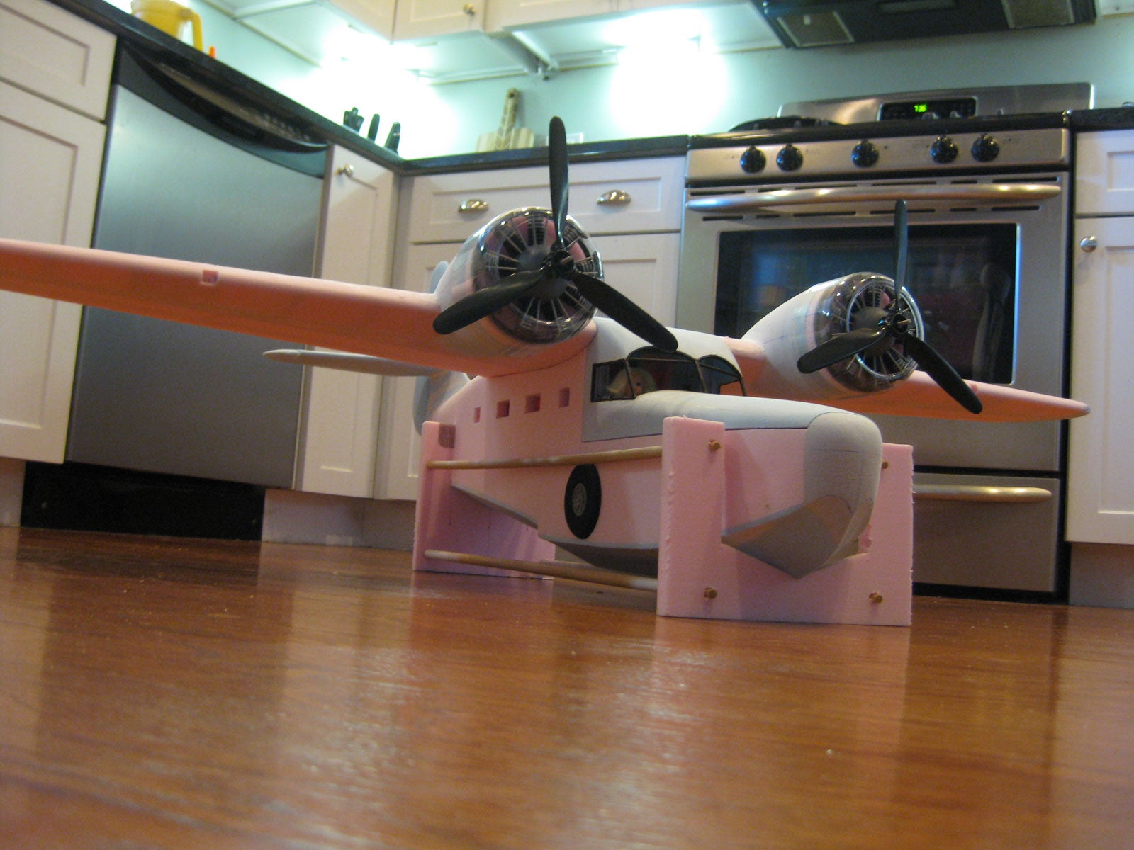

My Goose has been slow-going with two young kids and lots of finishing touches to do on the house renovations, but I just about have the fuselage finished and ready for covering.
I'm going to use newspaper and Titebond II wood glue which should give me a water-proof covering that can also be painted. I'll patchwork the newspaper into place in small sections to prevent warping as the paper shrinks, plus it will look like panel lines from the full-scale.
Right now my weight without battery is 2lbs-11oz, but I still need to add the floats and empennage servos/linkages. I suspect the covering and paint will add quite a bit more weight, but should still come in well under 4lbs with battery.
So based on that, here are some guesstimates:
581.4squin wing area
58oz AUW (estimated)
Max CL 1.25
Wing Loading 14.37oz/sf
Cubic Loading 7.15oz/cuft
Stall Speed 16.8mph

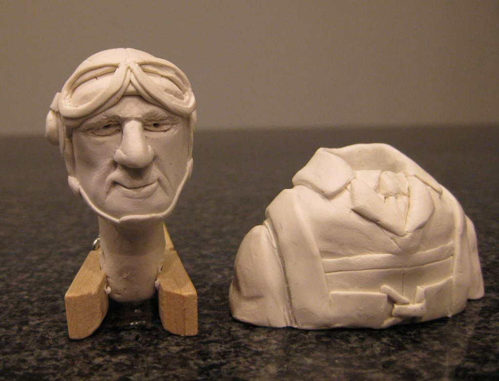

It's been a long while in the works, but I'm making another pilot for one of Hammerd's masterpieces. I had this dude nearly done and dropped him - smashed the torso and had to start again. Anyways, I have everything but the arms done and they are roughed out with some clay on armatures. This will be a 6-piece mold plus the goggles... arms, legs, torso, head.
Here are a few links I used for reference for the uniform:
http://www.dieselpunks.org/profiles/...ir-world-war-2
http://www.dieselpunks.org/profiles/...ir-world-war-3
http://www.theaerodrome.com/forum/pe...vil-image.html
http://www.flieger-album.de/geschich...aits/index.php
http://www.flickr.com/photos/drakego...detail/?page=4
The pilot is definitely of Austro-Hungarian descent with his trademark "Franz Ferdinand" moustache.

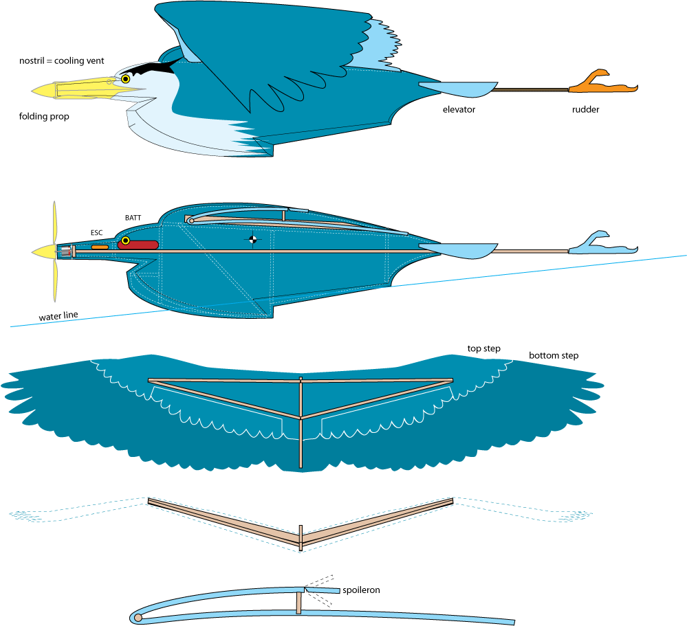

I had nearly forgotten about this design... A Great Blue Heron made from FFF... might actually ROW as well. KFM wing with spoilerons for roll control.
Thanks IBIPS for reminding me.
