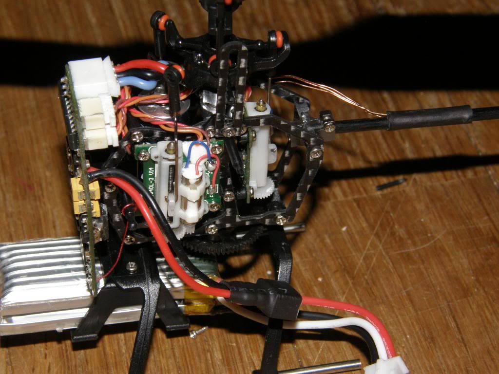

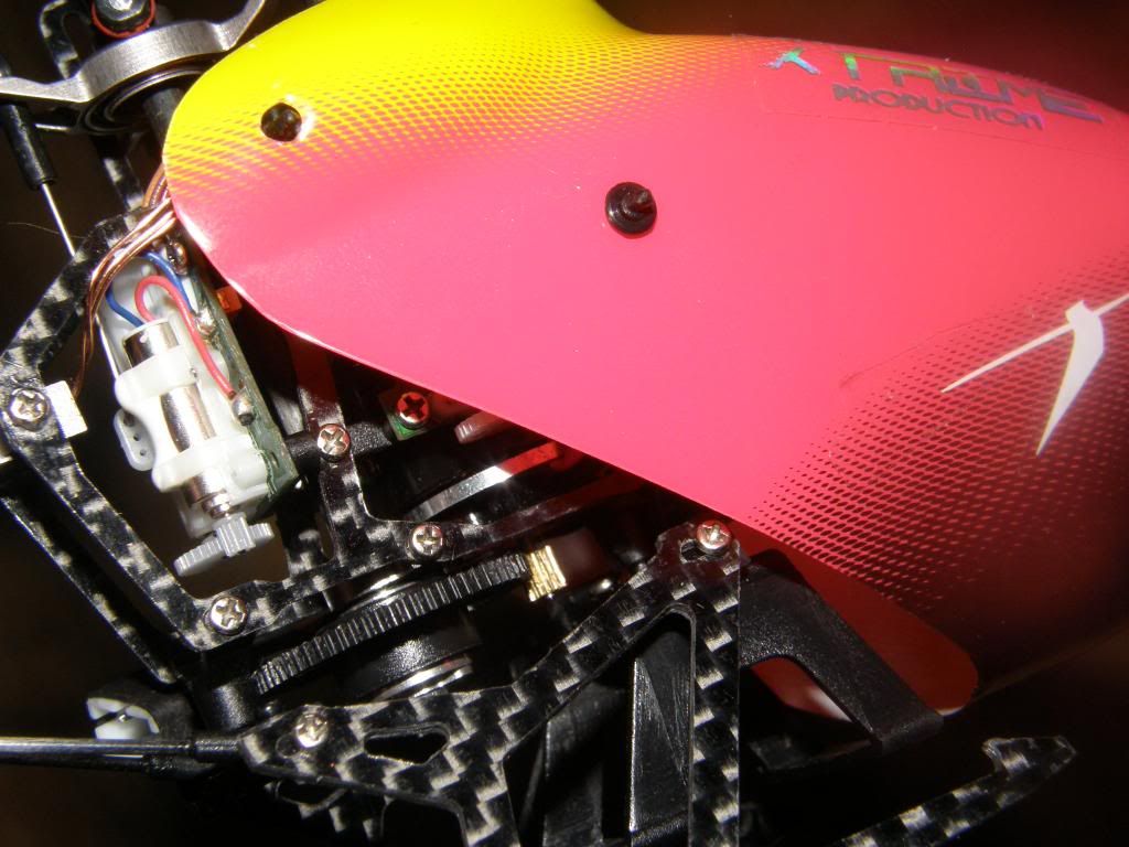

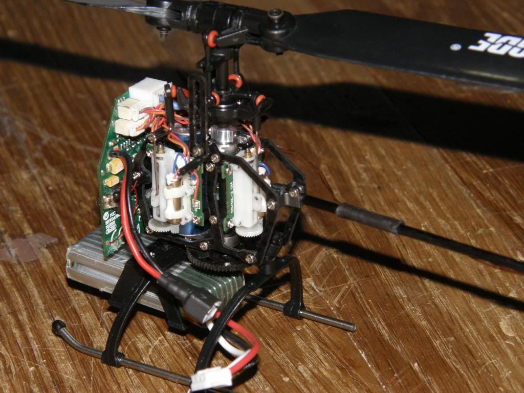

I built myself a twin tail motor setup for my mCP X. I used a 7mm and a 6mm motor because it's all I had laying around. Got it soldered up yesterday.
Went outside again for another test flight with the twin tail setup, the tail is simply rock solid! I did use a V-Curve to add pre-compensation because it would kick out a little (not blow out, just a little kick) and now with the V-Curve it's simply solid! I have always wondered what it's like to have a mCP X with a solid tail... well, now I know I can't wait until tomorrow when there's light and I can test it in 3D

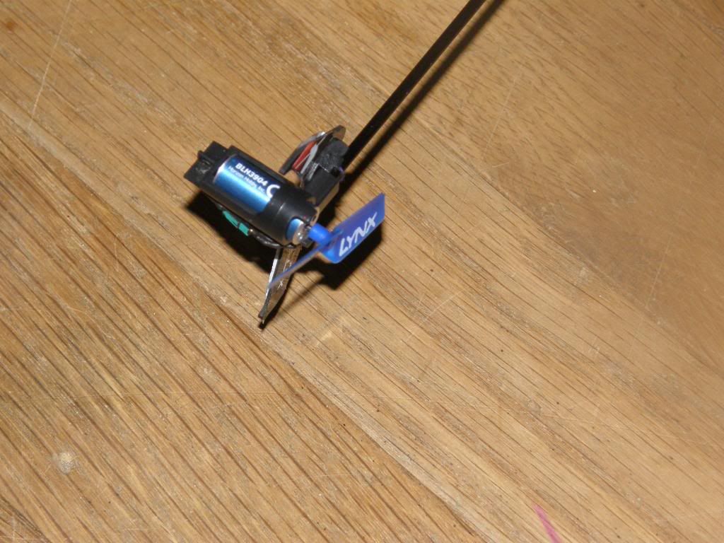

Green blades because they were the only pair that was balanced...
Custom tail. Soldered tail wires to a 7mm motor that came from a Xtreme Turbo Tail for Nano CPx. It was a total PITA to solder those teeny tiny wires but I got it done and it works great, especially compared to the stock tail.
