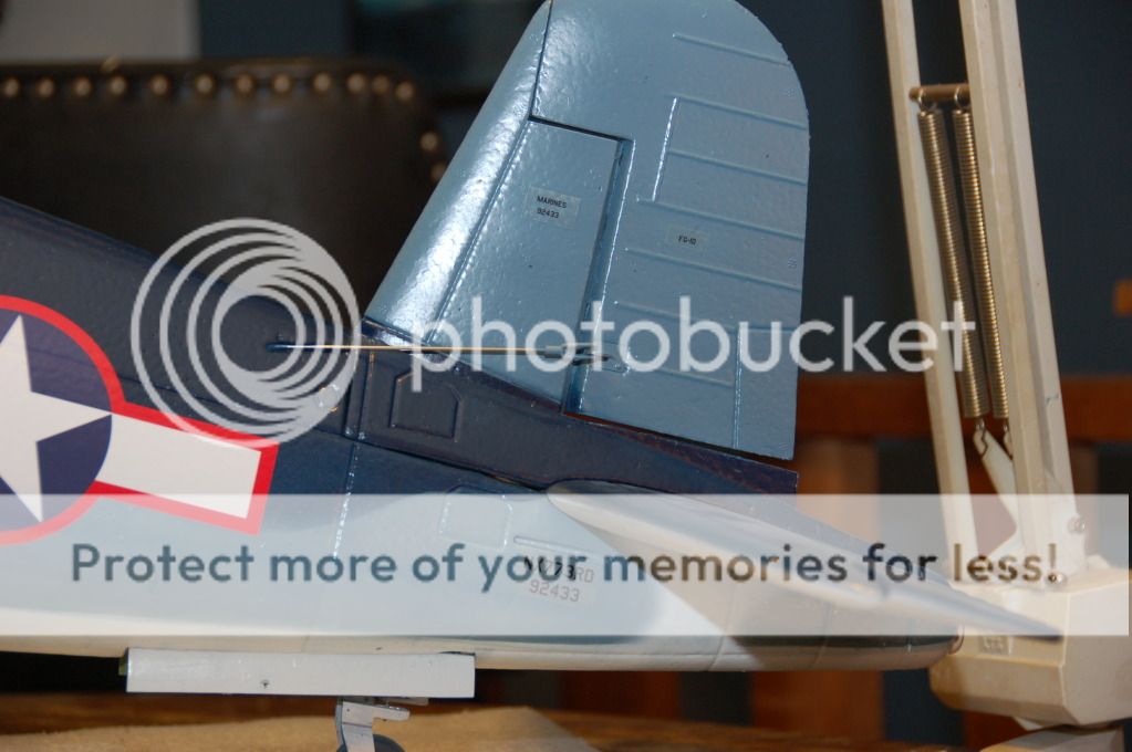

My original plans for the tail section was to figure a way to conceal the rudder linkage inside the tail assembly. I came up with a good way to do it, but with the advise from my good friend Tony/LiCobra, I shelved the idea when the issue of the Corsair being a bit tail heavy arose. Knowing I was going to be installing my workable tail wheel assembly, I decided against this mod in lew of that. I did install a small square CF spar in the tail end of the rudder assembly base because that area seemed to be a bit weak?
I did re-hinge both the rudder and the elevator with CA live hinges. My previous attempts at this mod on the P-51 & P-47 proved exasperating because I couldn't retain the CA from spreading onto the flexible part of the hinge, thus making them rather stiff! This time I took a different approach. Knowing I was going to be re-painting the plane anyway, I decided to install the hinges in their slots, then take a small bit and drill a hole into the foam and thru the hinge material. That way, when I shot the CA in the holes it would spread evenly through out the hinge material. Doing this procedure I was able to keep the CA from spreading to the hinging parts of the live hinges. Once everything was done, I filled the holes with Squadron White Putty.
Once the rudder was done, I started on the elevator. First thing was installing a .080 joiner rod in both control surfaces to eliminate the need for 2 servo linkages. I did this...Continue Reading

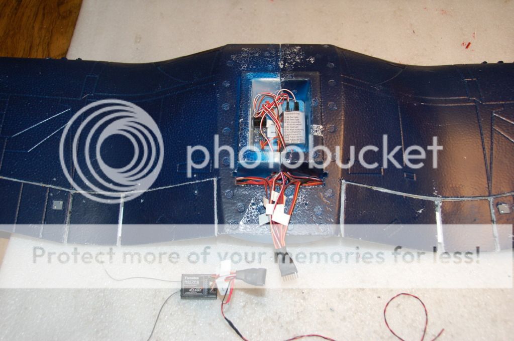

After completing the Flaps and the 1-Piece wing mods I proceeded to get started on the wiring, and getting the electronics located where I wanted them.
Because of the cramped quarters in the cockpit, I thought that nifty recessed box in the wings was a perfect place to install the LG sequencer and the Landers Nav Light Controller. This worked out great as I was able to combine both the aileron and flap leads into 1 which only took up 6 of the 14 pins on the 14-Pin multiplex connector I was going to use. I then combined both the B and C leads for both of the LG assemblies to the sequencer thus eliminating another set of Y-Connectors. I then ran the sequencer lead to 3 more pins on the multiplex. The switched lead for the Landers Controller took up 3 more pins, and that left me 2 pins to hook up leads to the tail light. The leads for the landing light will come up thru the cavity just behind the box and run directly to the controller.
The multiplex connector comes up thru the opening in the fuse, and plugs into the RX already mounted in the cockpit. WaaLaa, no Y-harnesses and annoying excess wiring hanging around and cluttering up the cockpit! It looks like the only 2 Y-connectors I will need is the one combining the rudder and tail wheel steering servos to the RX, and the other to combine the tail wheel to the LG lead. That will work fine as they'll be tucked away somewhere in the tail.
This plane is fast becoming my favorite!

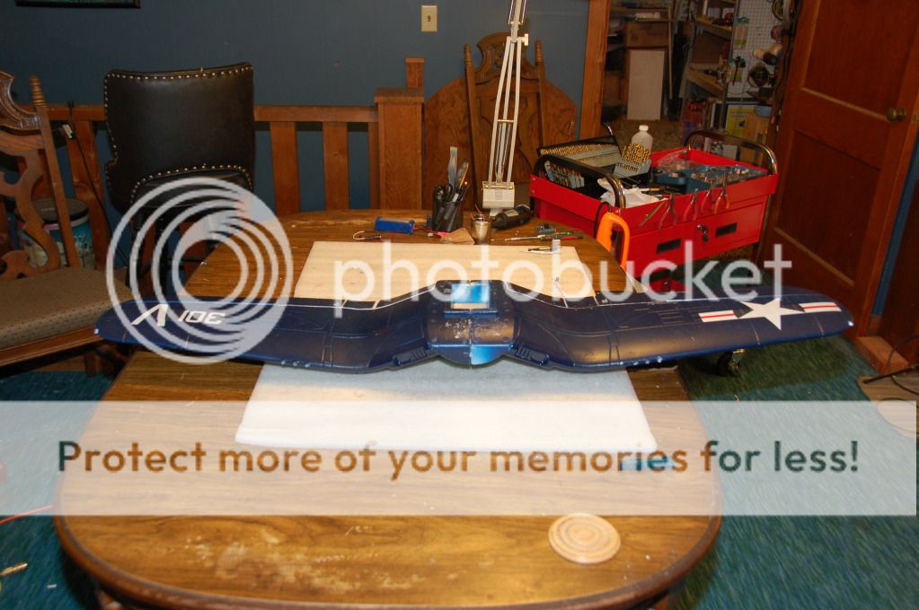

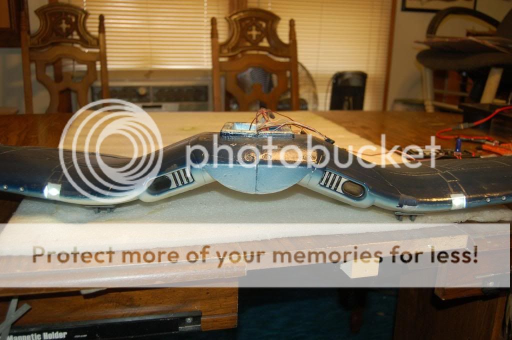

Posted by Sandancer | Nov 14, 2010 @ 01:20 AM | 16,565 Views
Now that the flaps are done, the servo sockets cut, the wiring ran for the Nav lights, and the holes cut for the Ma Duece guns, it's was time to glue the 2 wings together and make them a 1-Piece unit.
Because of the gull wing configuration, I picked to spots, one aft and one forward (as illustrated in thumb #1). I utilize (2) .3940" O.D. CF Tubing for spars, (1) 4" long for the aft location and (1) 8" for the LE location. To line up the holes on both halves I cut 2 pieces of 3/8" X 1/2" brass tubing and pressed them in the chosen location on one of the wings. I then lined the other wing up and squeezed the two together to leave an indexed impression in both wings. Knowing I was going to be using Gorilla glue with it's expansion properties, drilling the (4) 3/8" holes in the two wing halves didn't have to be in perfect alignment, but I did manage to get that process done to my satisfaction.
I then cut a 1/8" ply plate 2 1/2" X 3 5/8" to go in the base of the box for additional reinforcement and to serve as a foundation for the velcro I would use to secure the electronics I plan to mount in there.
After applying the GG in the spar channels and wing mating surfaces I secured the wings back on the fuse to insure a perfect alignment. To help corral the GG I ran some tape down the seams of the wings to subdue the GG expansion, and also put a strip of tape on the fuse to prevent any glue expansion from seeping out...Continue Reading

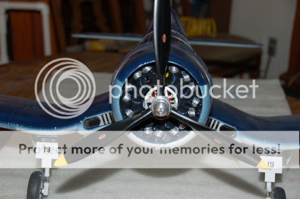

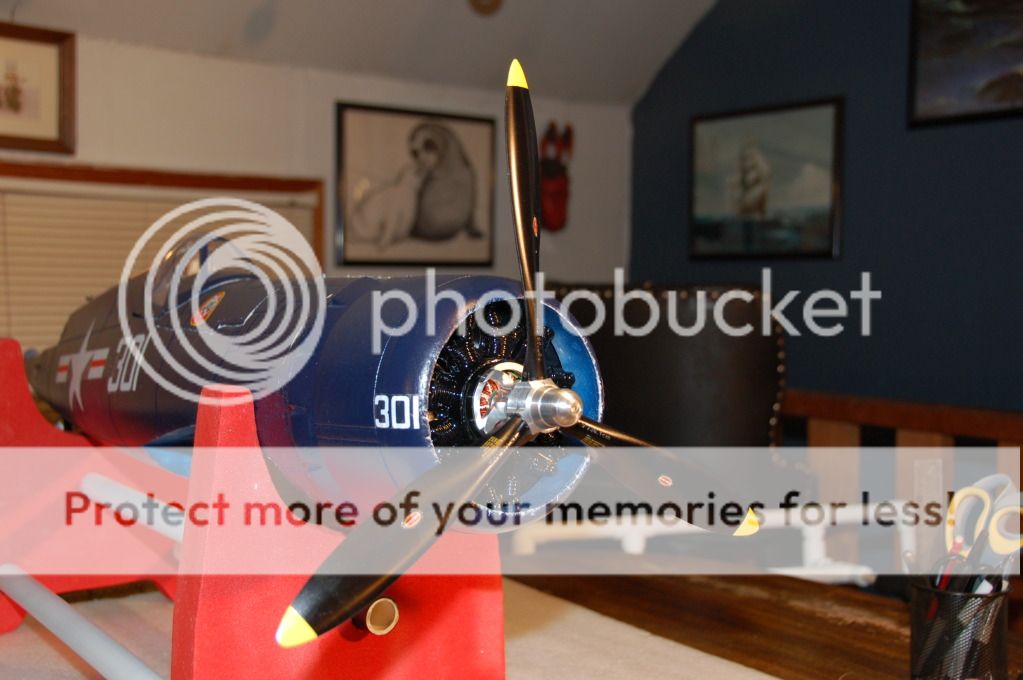

I am going to utilize the Ramoser 3-Blade VarioPROP with the Corsair.
With the VarioPROP the options are open to what combination will work best with the SK 580. In these pics I am showing the 15" scale blades and the recommended 13" scale blades.
I will also be able to install a 4-Blade hub, and have the option of running 4 x 13's, or go to a 2-Blade set-up, and experiment with 2 x 13", or 2 x 14" speed blades, or even 2 of the 15" blades?
My plans are to run a 5S lipo with this set-up, and as soon as it arrives I will post performance specs. respectively.
UP-DATE 12/07/2010: I thought I would preview additional options the VarioPROP offers for the Corsair. In addition to the 3-Blade set-up, I can also install the 4-Blade hub, and experiment with either the 13" & 15" Scale blades, or the 14" Speed blades which I will probably use in a 2-Blade configuration?...Continue Reading

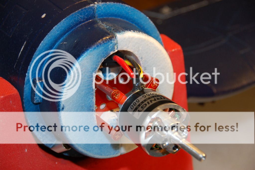

This mod took a little more time to complete as I had to split the forward section of the fuse so I could re-align the firewall correctly. Once everything was glued back in place I could then design the a new motor mount for the SK 580 to fit the Corsair.
I once again used the X mount that came with the motor. I then designed a firewall mount and then joined them together with aluminum tubes.
UP-DATE: 1/23/2011:
I've updated the attachments to show how I attach the motor mount to the firewall. I've also included pics of the TGY SK 5055-580kv retaining shaft collar that comes with the newer motors.
UP-DATE 2/16/2011: I received the up-dated Turnigy/FMS motor mount from Gary at CustomRC yesterday and wanted to post some illustrations of various options this new mount has to offer for those who have chosen to use the Turnigy motors in the FMS 1400 Warbirds.
I'm pretty sure this mount will adapt to other manufactured motors, but all I have are the Turnigy's, so that's why I'm using them as examples....Continue Reading

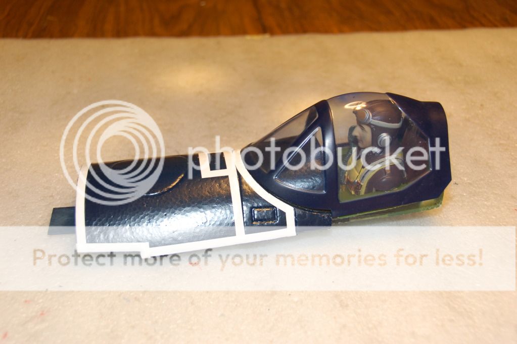

Once again "Goofie" was excused and sent home. His replacement is the ESM WW II American pilot. Some serious surgery had to be done so he could fit in the cockpit.
To repaint the interior I first removed the blue paint with compressed air and a needle valve air gun. Once I got all the paint off I sprayed a coat of Dupli-Color Adhesion Promoter CP199 to seal the foam. I then painted the interior glare shield with Krylon Semi-Gloss Black. The interior was airbrushed using Model Master Interior Green FS34151, and the seat with MM Leather. I then did a pin stripe down both sides to simulate some aluminum channel with MM Bright Silver. The canopy was tinted with Ritz Royal Blue.
I followed John/Allelectric's hatch mod and cut the forward cowling to open up the battery compartment. When I'm done with all the mods and ready to repaint the plane I'll secure the forward hatch to the cockpit with glue and a couple of CF rods and make it 1-piece. I'll retain the 2 magnets to hold the cockpit/hatch assembly in place, and make a retainer piece for the front of the hatch to secure it to the cowl so internal air pressure won't blow it off.
UP-DATE 11/21/2010: I've got the Battery Hatch mod done. I made a retainer plate for the front of the hatch to secure it in place. Because the lower foam lip at the front of the fuse was a little feeble, I made a 3/32" ply plate to reinforce that area and glued it in with GG.
I had to enlarge the...Continue Reading
