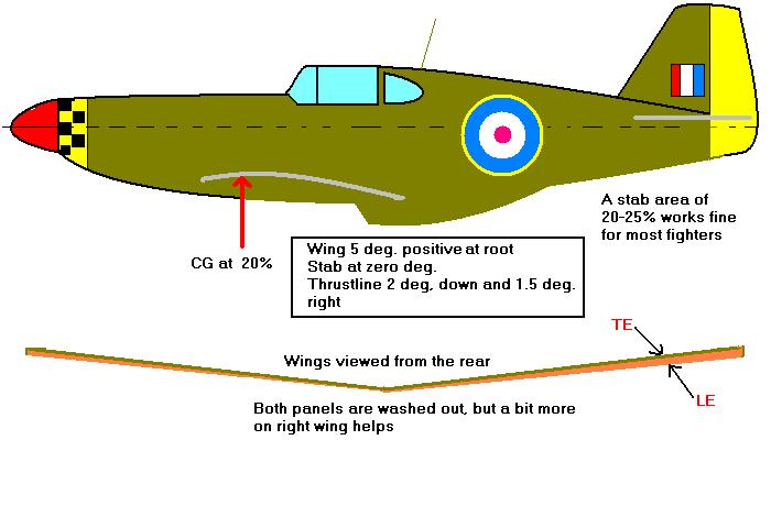

This is my standard low wing trim for WW2 fighters based on freeflight experience --- the flight pattern is safe and docile, but remember that throttle setting is effectively the elevator function in rudder /motor equipped models; If you use elevator as
